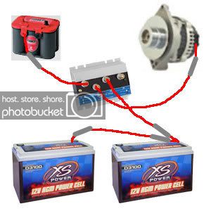

OP, are you planning on isolating the front battery from the rears? If so, I would go for a Redtop. If you are not going to isolate, then go with a Yellowtop, or another Powermaster to match the D3100. The reason I asked about the isolation is that you never want to deep cycle that Redtop. If you do not isolate the Redtop and you deep cycle one time, you could end up with a dead Redtop and have no warranty. Optima specifically states that there are no warranties for a Redtop used for car audio. If it is not isolated, it is technically still powering car audio.

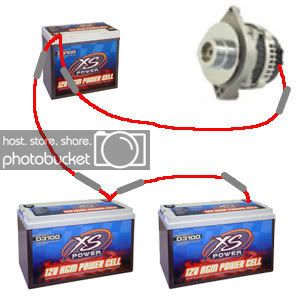

Forgive the kindergarten level photoshop drawings below. The little gray pods on the wires represent where you may need to fuse, depending on the length of the wires.
Sample 1 (with isolator + Red top)
Sample 2 (with PM D2400)
