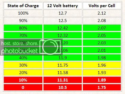

define depth
I have seen batteries meter 12.8 and as soon as you put a load on them drop significantly.//content.invisioncic.com/y282845/emoticons/fyi.gif.9f1f679348da7204ce960cfc74bca8e0.gif
Depth as in this chart:
