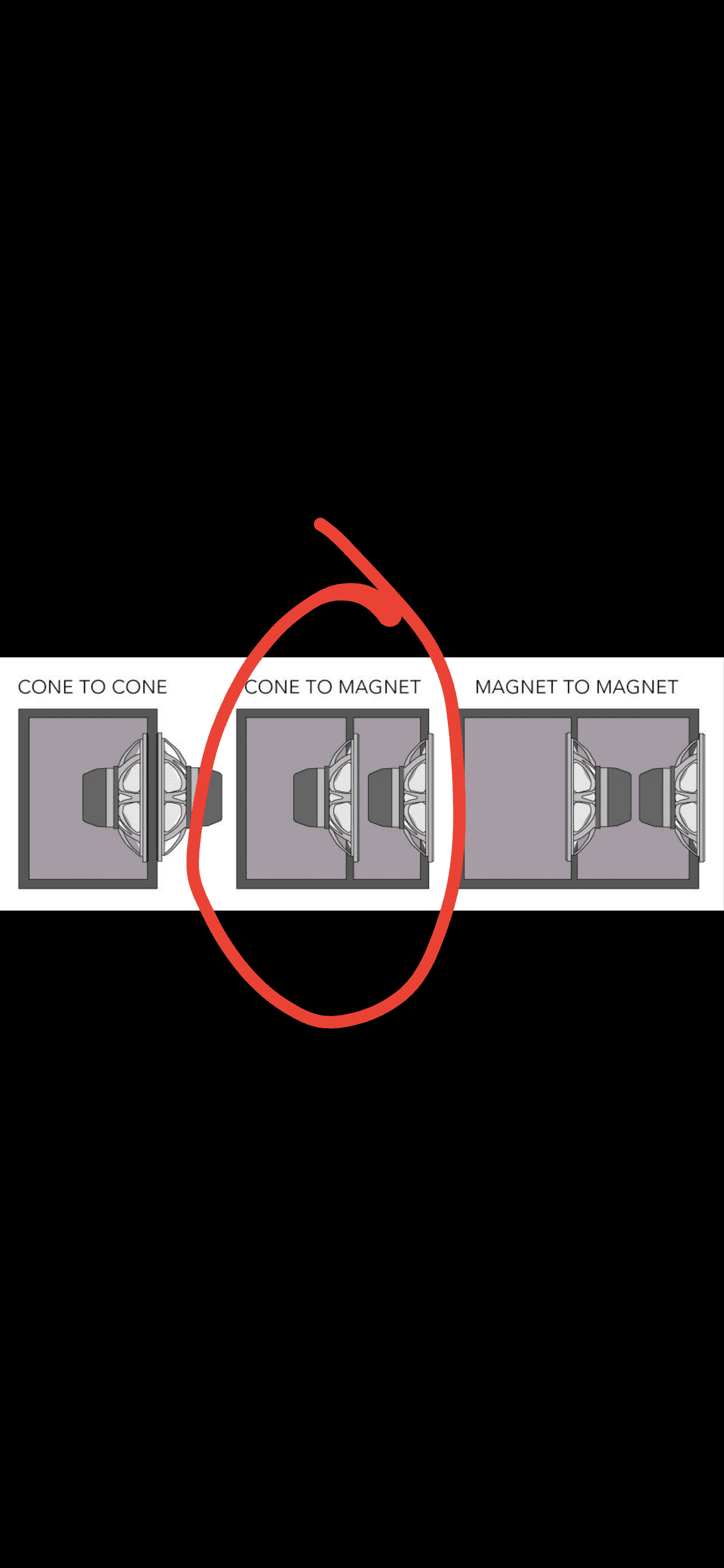

I have never tried that but I assume it would be hard to make it work. Reason is that is similar to a passive rafiator set up. A passive radiator works because of the weight placed on the PR for tuning. If the other sub is placed on the opposing side I would assume cancellation would be the natural outcome since both subs are moving in opposition to each other. After all, that is the wiring method for an isobaric setup.
Only isobaric method where both subs are wired the same is when one sub is mounted on an inside partition facing the same way as the outer sub.

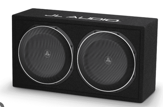

And just to clarify, the dual-opposed looks like this
, whereas the standard box would look like this
Neither is ported, the drivers are the same, they both share the full internal volume of the box, they are both wired in-phase relative. The only difference is baffle position.
