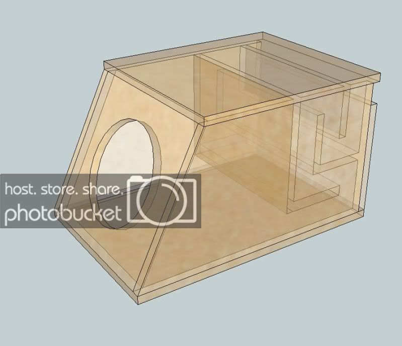

I have to say I have built some Award winning boxes in my day, but I have never designed or built a box design quite as impressive as the one Mobile Enclosures had done for me. It's amazing that the usable frequency is very broad. When I say broad, I mean BROAD! I recently was able to get a hold of a Termlab and really get into tuning my system, and I was able to get an almost completely flat response from 29 hz to 120 hz at 120 db. It was really quite amazing. 3 db drop off at 28 hz and a 2 db dropoff at 122 hz. I will have to say the speaker in the box is not the one it was designed for either, its a JL Audio 10" 0w1v or something (super Cheap) 150 watts, and the one it's designed for is the new SSA Icon 10" which I am waiting on to come out, but it's 1250 watts. I expect to get a flat response up to 132 to 137 db and maybe max out spl at about 140. This is with one 10"! This is the enclosure

this is what I would use if I were you OP

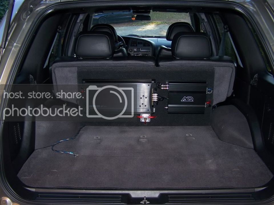

That's a nice looking design, but realistically might be more complex than I'd want to attempt. Also just eyeballing it, I'm not sure it'd fit in the back of my pathfinder.
DD 2512 in a small SUV you say???
I have a hell of a 4th order design that is sick w/ that sub in small SUV's.
Its a very easy build also. Its about the same size as an average 2.5cuft net vented box.
