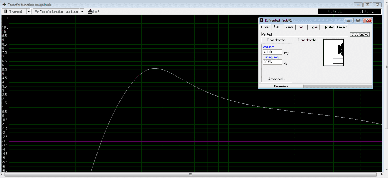

That's at 950 watts of input... nice response curve too.
Looks like it'll dig fairly deep too... Winisd says it hits that 25mm x-max around 25hz on that power. How much power is he planning to run?

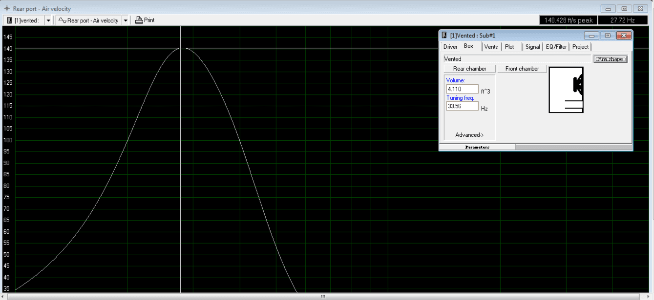

Really an 8" aero around 23-24" long (depending on volume) looks better for his power/volume/tune... if you can keep it about 4ft3 net
As a rule I always think of it like this... if their askin' for 70in6 of port you'll need 20% less if using a round... that's about 50in^ so that 6" is just a little small... 28in^... looks like it'll compress to me... and that means output will suffer at high volume.
Dual 6" need to be around 29" long, single 8"... about 23"-24"... both for about 4.15ft3 net... that's why I recommended an 8". The dual 6" are gonna be long af. Using a bigger port does not drop tuning... lol
