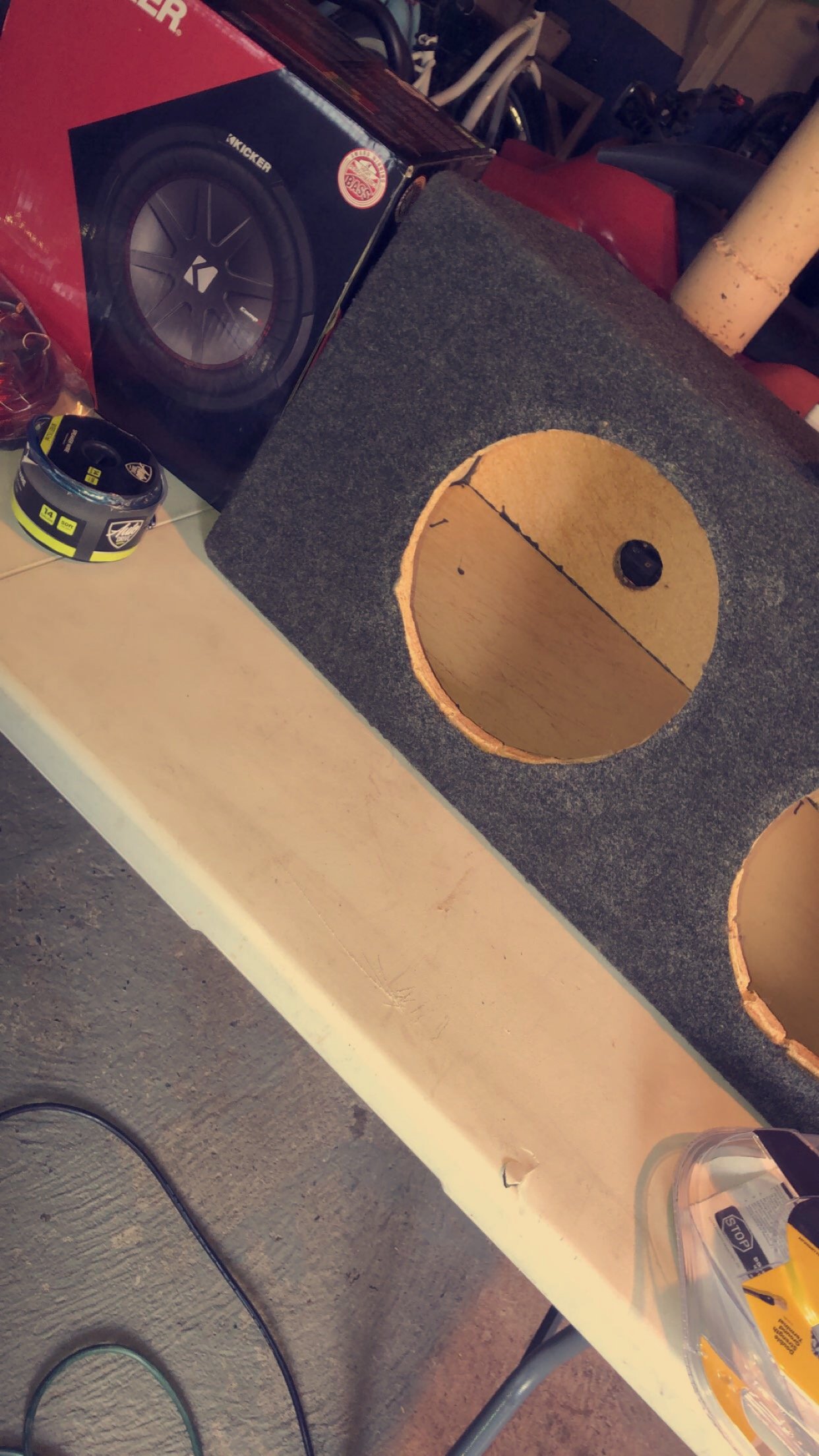

I asked to see if you were running them in mono or stereo but I'm going to assume its mono so that would rule out one of the channels of the amp.
Is the box one chamber or does each sub have its own chamber.
When you open the box up do they all share the same air space or is there something sealing them off from each other.
Maybe post some pics
There are 2 chambers in the box and a divider in the middle
This is the only pic I have. Like I said it’s divided in the middle. I can get more pics later on.
If it is divided in the middle then try switching the subs and see if the problem follows the sub or stays on whatever side its on.
If both subs are in individual chambers, but one moves more than the other, he has already narrowed it down to a sub issue.
Pull them out of the box and measure coil resistance.
What if there is a hole in the box or one the seals on one side are gone?
Would that not cause one of the subs to not run as well as the other one?
That's not a very likely scenario. Might as well check if one half of the amp's terminals doesn't measure the same voltage as the other half. That could cause his issue.
