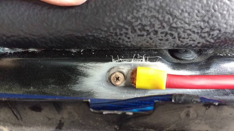

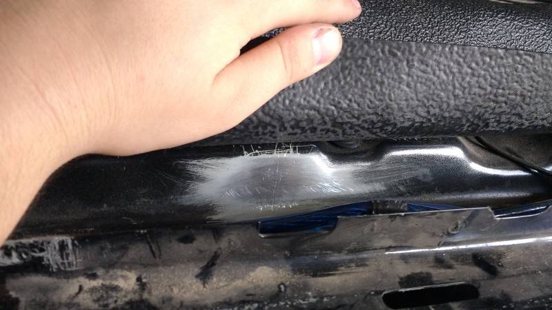

So i moved the ground wire over a bit, noise remains. This is after i grounded the HU inputs again and then grounded the amp inputs to the amps NEG terminal. Even with both grounded the noise remains. I have not verified any wiring under the hood though, thats my next check.
where exactly is your ground in relation to the chassis of your car? the first pic looks like its actually on a seat, ideally you want to get it grounded to a large piece of the main chassis of the car that has the least amount of bends, joining of metals, etc.
grounding the rca shields will usually make a difference in the case of a ground loop, it could be a bad headunit or amp at this point although it could be a ground loop still. it's a long process but you'll figure it out by elimination eventually.
how long is your amp ground wire? that wire terminal looks pretty oxidized, you probably know this but be sure to sand the bottom of the terminal as well if it gets like that
