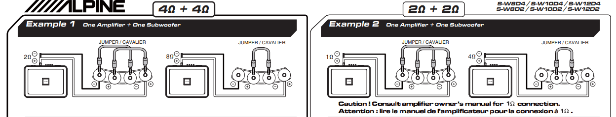

The Punch 100 is listed as 50 watts RMS per channel into 4ohms. The sub wiring diagram includes the following for one amp into one sub.
To get both channels (L&R) into the one sub, do I combine the L&R positives and and separately the L&R negatives from the amp output thus giving me 8ohms as depicted in the 2nd picture from the left? End result being both channels and 100 watts into the sub?

For the sub/amp combo, you can use one voice coil per channel. So no need to use the jumpers of the sub.
