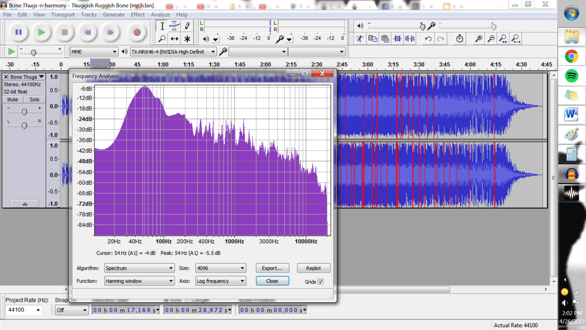

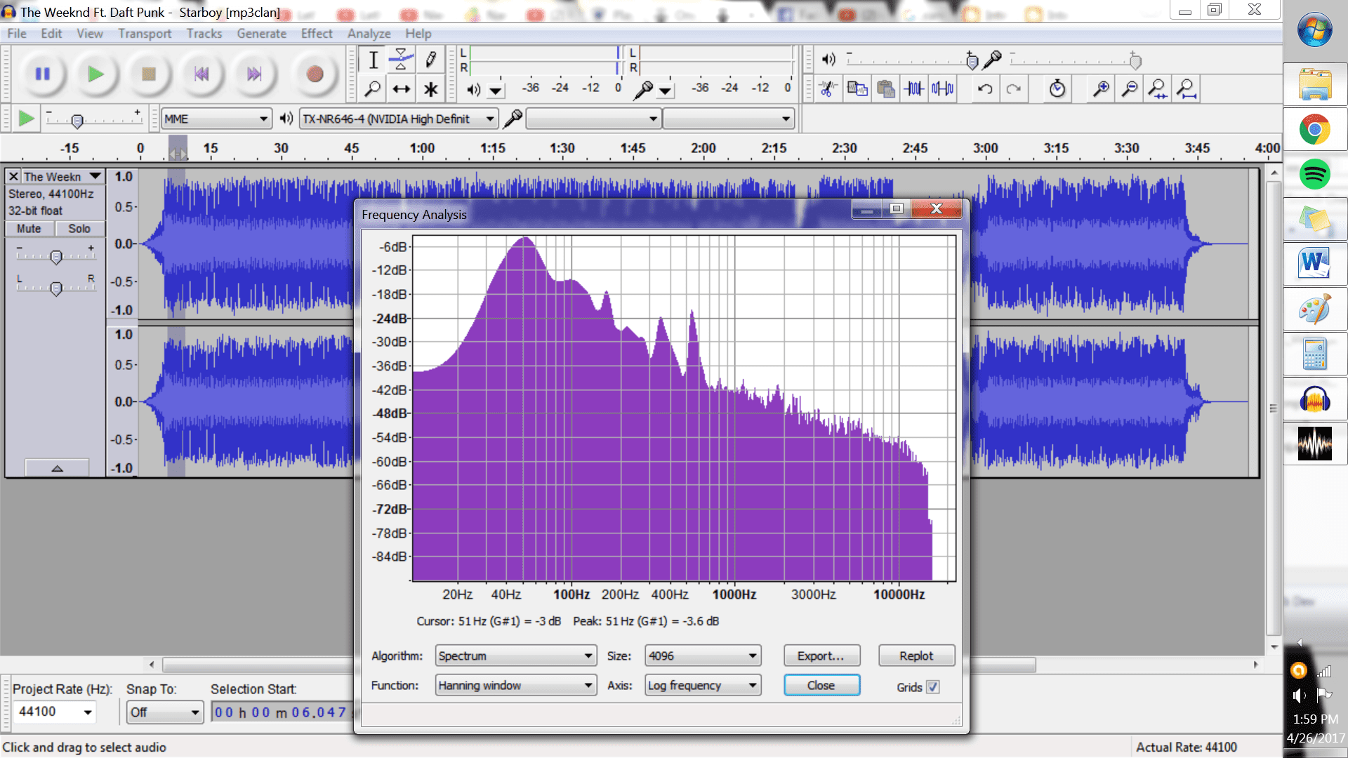

Thats middle and high all of those. none of them reach low at all. All the old school hip hop mainly 40hz and up. The new school rap sometimes play down to 30hz rarely do you see anything dropping lower. again, starboy was 51hz. thuggish ruggish bone is even higher frequency. you arent playing anything deep or low. No sense in having a setup that emphasizes notes you dont even reach.

for his music, if you analayze it on audacity's spectrum analyzer, none of his stuff plays deep bass at all. 51hz, 54hz. Most of the subs nowadays are geared for 45hz and under unless you use a special 1/4 wave transmission line design to make the sub play an octave higher.
