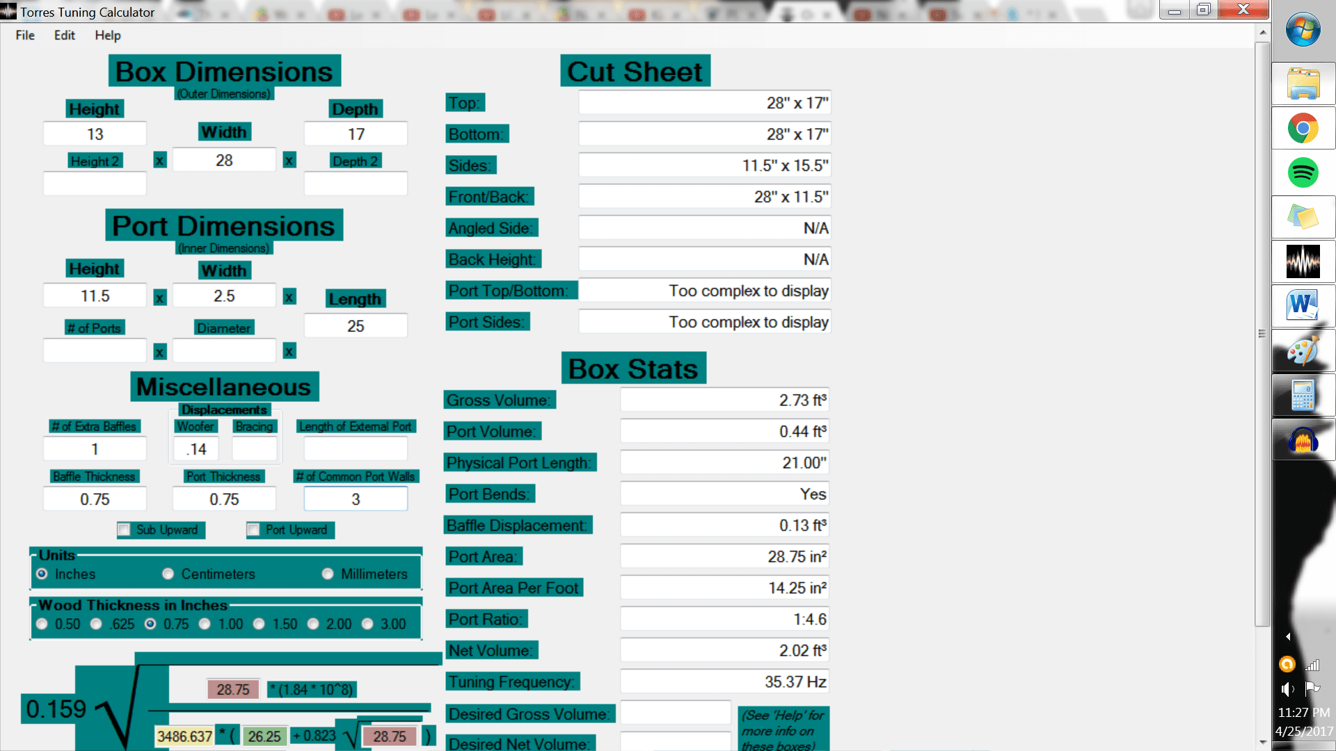

a proper box will look like this for a single 12. Your current ported box for two 12s is poorly designed and is strangling your subs and tuned too high. I'd do a single 15 sealed or two 12s sealed if you want to save space.
Space makes bass and ported requires A LOT of space.

yeah, we can adjust the height and save width room or add more width and save on depth. however you want. be warned it'll be on a completely different level than your CV subs in terms of output lol... pretty heavy too, might want to use sanded 11 layer plywood or baltic birch or arauco ply to save on weight. the sub says 750 watts rms but you can feed that whole CAB 1600.1 to the sub and it'll handle every last watt that amp can put out easily.

I would suggest doing sealed boxes instead with two 12s in all honesty. Most of the subs nowadays are engineered for low frequency response and if starboy and top 40s is the type of bass you want, you need that upper range. Being sealed it'll still play rap just fine as well but you definitely need the upper frequency response when you start playing top 40s and rock.
