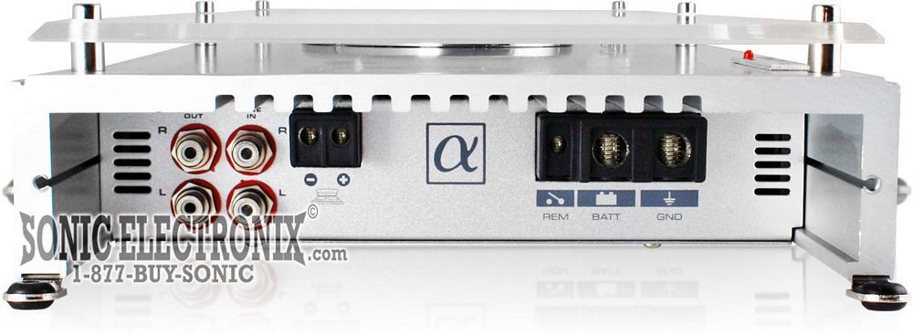

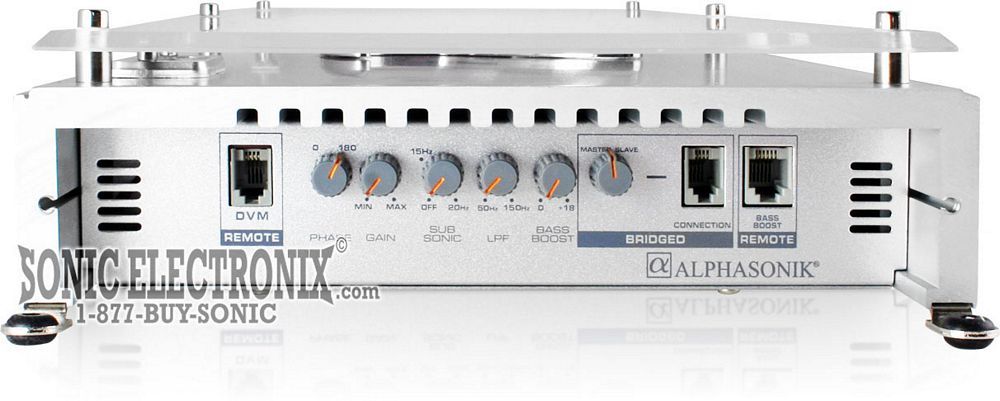

  • 1-Channel Class D Mono-Block Power Amplifier
  • RMS power Rating:
    • 1200 watts x 1 @ 4 ohms mono
    • 2000 Watts x 1 @ 2 ohms Mono
    • 2470 Watts x 1 @ 1 ohms Mono
  • Bridgeable with Second Identical Model
  • 3’ Modular Cord Included
  • Hour Meter
  • Remote Mount Digital Voltmeter Included
  • Remote Mount Bass Boost Control
  • Heavy Duty One-piece Extruded Aluminum Heat Sink
  • Variable Low Pass Filter: 50Hz~150Hz, 24dB/Octave
  • Variable Subsonic Filter: 15Hz~40Hz, 24dB/Octave
  • Variable Bass Boost at 45Hz: 0~+ 18dB
  • Variable Phase Shift: 0~180°
  • Input Impedance: 10K ohms
  • Variable Input Sensitivity: 300mV ~ 8V
  • Beveled Clear Acrylic Protective Cover
  • Tiffany-Style Input and Output RCA Jacks
  • Parallel Line-out RCA Jacks
  • Removable Covers Conceal Control and Terminal Panels
  • MOSFET High Speed Switching Power Supply
  • Milspec Double-Sided Glass Epoxy Circuit Board with Through-hole Plating
  • Heavy 4 oz. Pure Copper PC Traces at All Preamp and Amplification Stages
  • Internally Mounted Fan-Cooled Power Supply
  • Solid Brass Nickel-plated Terminal Blocks (4-gauge Power, 8-gauge Speaker)
  • Terminal Blocks are Compression Type and Soldered Directly to the PCB
  • 4-Way Protection Circuitry: Thermal, Short Circuit, Overload and DC Offset
  • Dimensions: 20-7/8” L x 9-1/8” W x 2 1/2” H
  • 1-year SonicElectronix.com warranty
Looks pretty straight forward to me.
