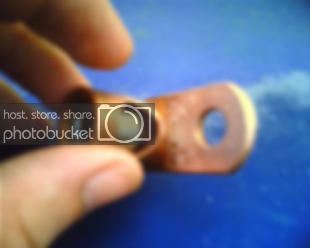

Official CarAudio.com Big 3 Thread
compared to my finger.
idk how much they cost though. they aren't cheap for sure.
