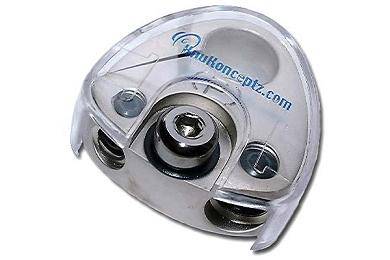

Buy new bat. terms from Knukonceptz

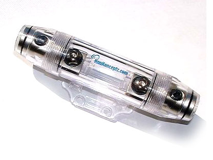

buy ANL fuse holder with a 250amp fuse
