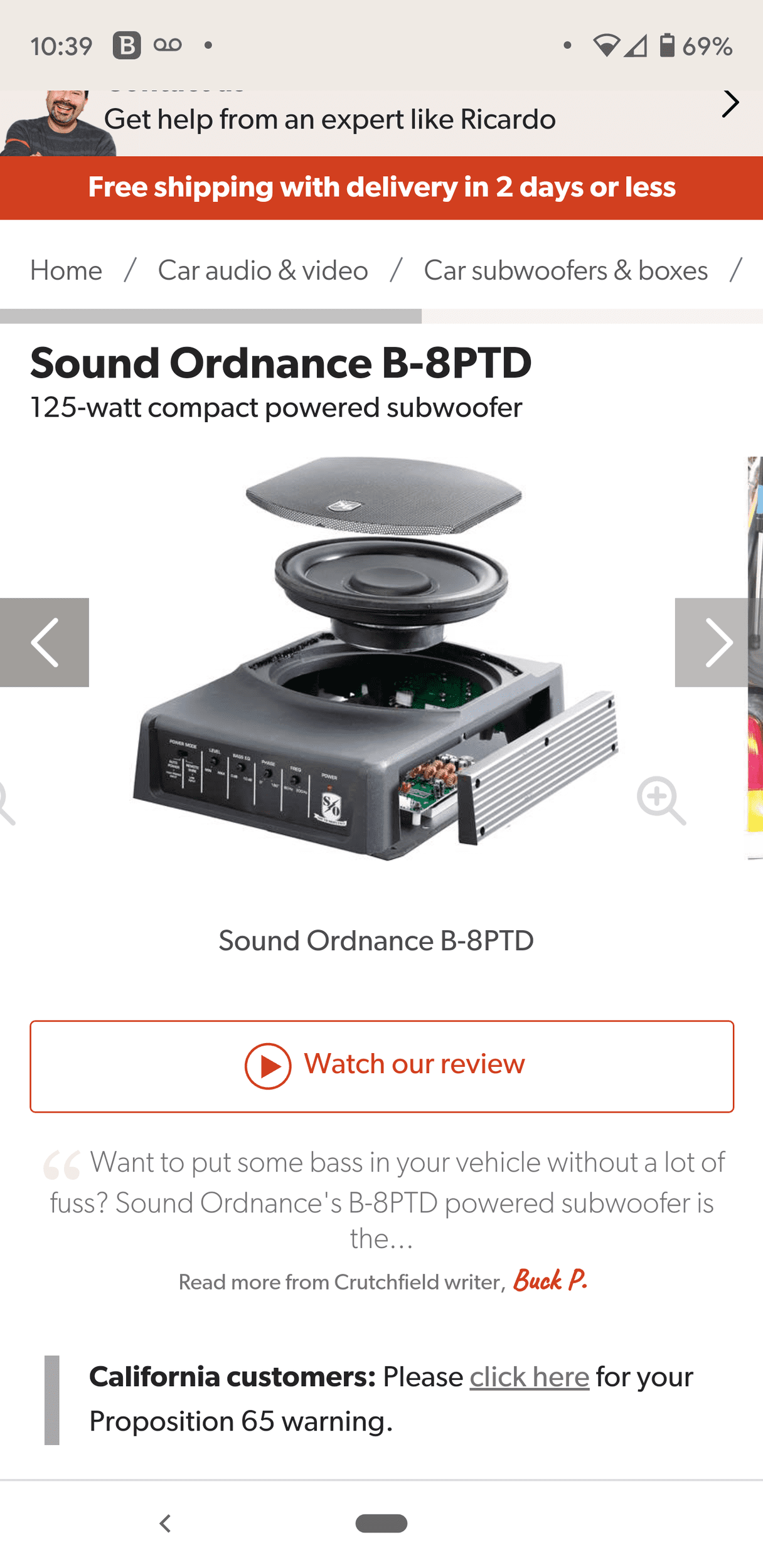

This is a Sound Ordnance B-8PTD from Crutchfield. I guess it's their house brand. I can already tell I might be replacing it, though. Even with the crossovers in place, it seems muddy and doesn't pack much of a punch. I prefer "tight, clean and punchy" to what it seems to be putting out currently.
To this point, I'm accustomed to taking measurements at the output of a device. Since the sub is the end of the chain, where do I measure?
Or do I just listed to the 50Hz test tone and do it by ear? (I'd prefer to measure if possible).
Hmmm, I'm not really sure how you would measure the output of the integrated amp. The only way I can think of is to pull the speaker out of the enclosure and get to the amp terminals.
If they used insert nuts to secure the sub to the box it shouldn't be too bad to remove.
Maybe look online to see if there's a teardown instructions somewhere.
Looks like you might be able to pull the heatsink off the side and access the amplifier.
Hm. I may have to pull it apart. With a 50Hz tone I hear what I think is distortion before I get to 30% of the level knob. And it's NOT loud enough... I'm interested to see what the scope says.
Planning to try by ear in a minute with a 60Hz tone ... Maybe the enclosure was vibrating?
Most people use 40hz test tones on the subwoofer so try that as well. And yeah I would take it apart and make sure everything was nice & tight on the screws. Who knows if something from the factory is loose. Plus you can always return it for something better.
