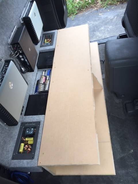

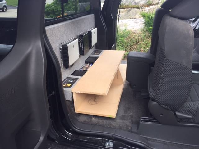

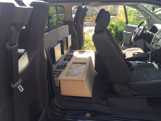

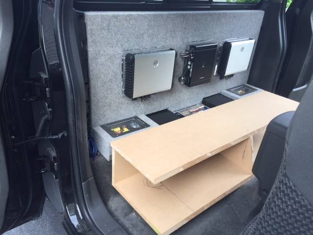

Starting to get an idea of sized and shape of sub enclosure....this is just a mock-up to get an idea of feasibility of what I want to do...the actual box will look a bit different. The idea is dual 12's sealed separate chambers, down-firing with the box about 2inches off the floor...and it will probably involve Plexiglas and LED's too...because I just can't help myself.
More to come...
Different kitty in this picture...but you should recognize most of the subs...you owned most of these actual subs at one point or another. //content.invisioncic.com/y282845/emoticons/smile.gif.1ebc41e1811405b213edfc4622c41e27.gif

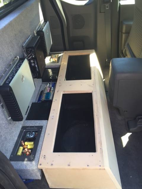

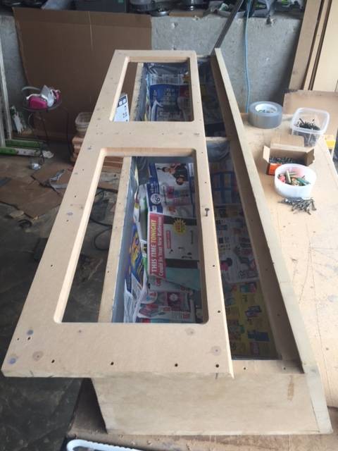

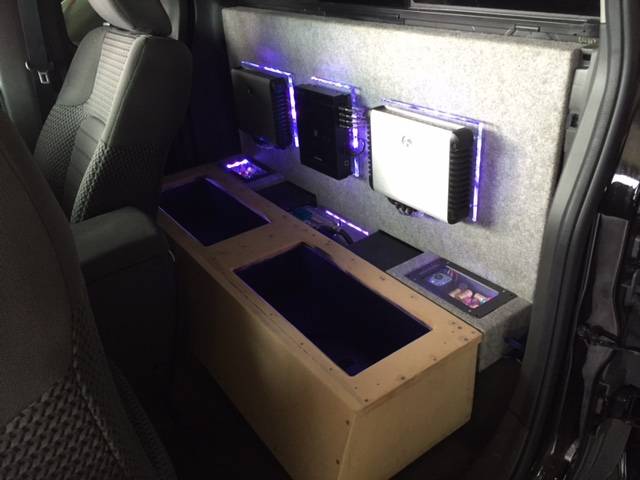

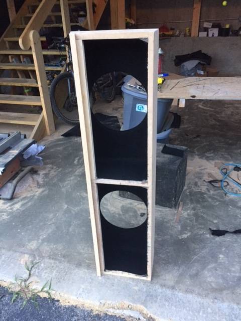

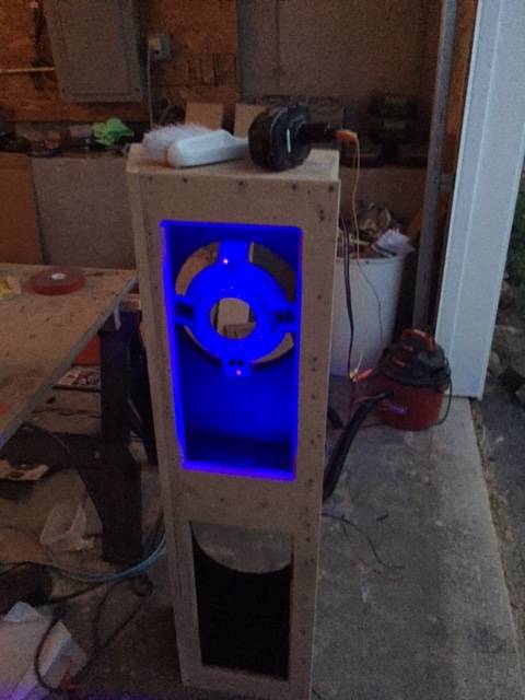

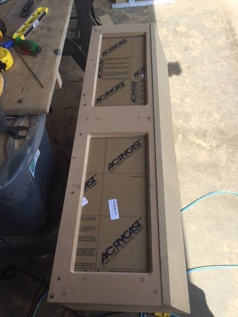

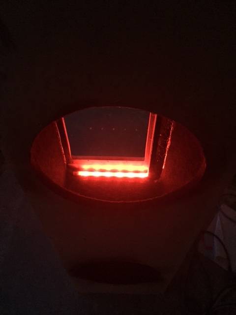

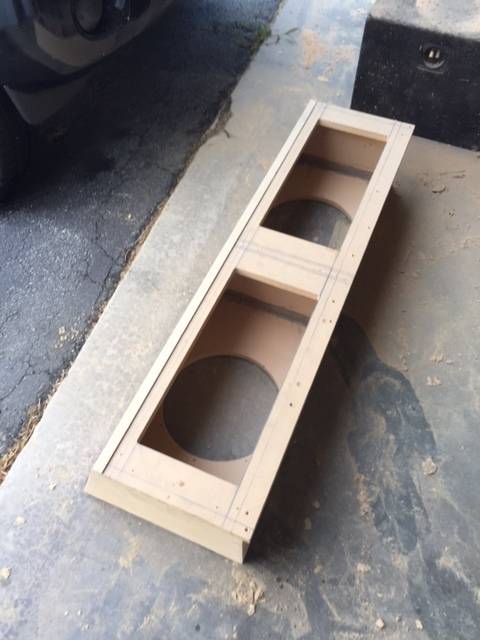

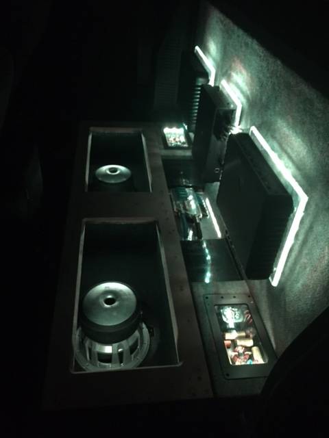

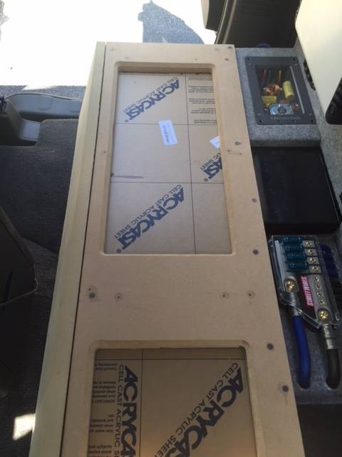

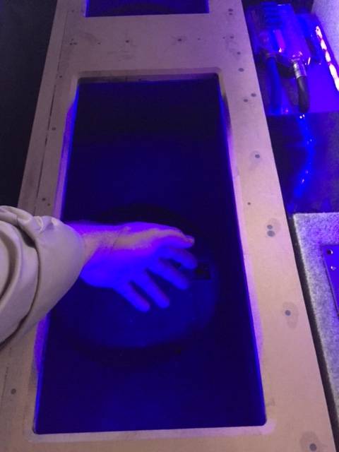

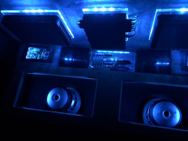

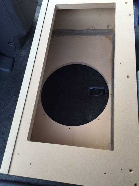

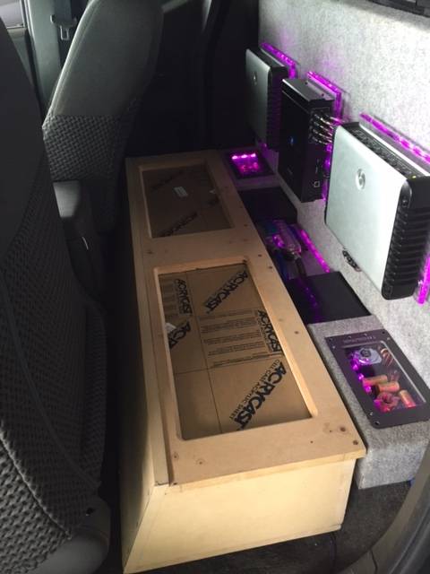

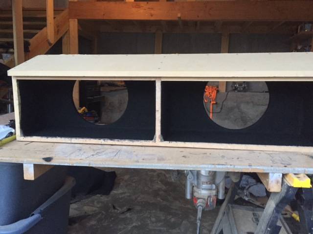

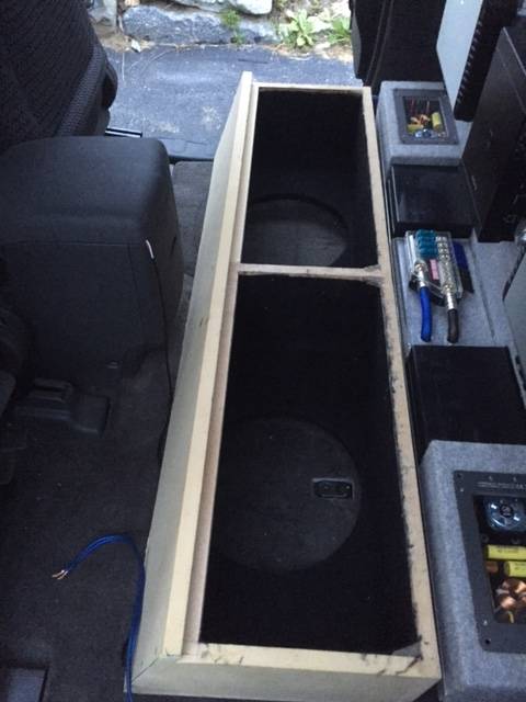

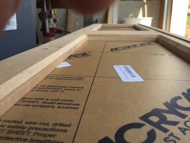

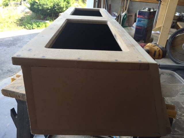

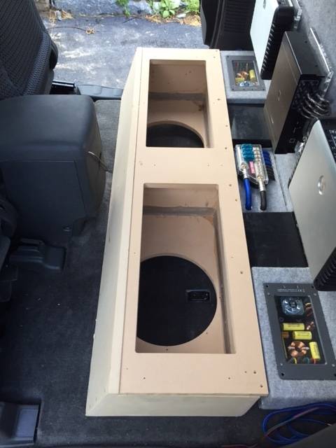

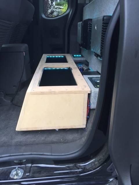

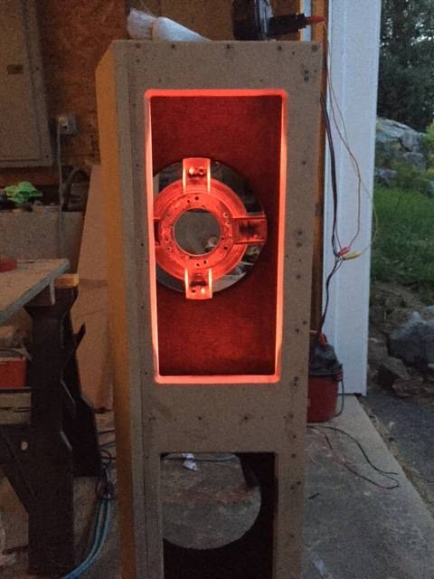

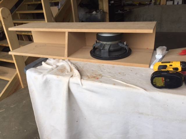

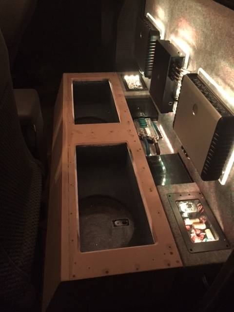

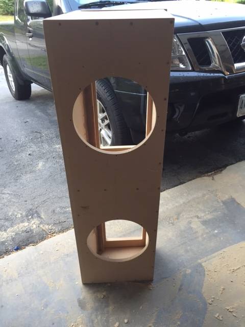

A bit of work on the subwoofer enclosure. Dual Audiomobile MASS series underhung 12's. Sealed, separate chamber, down-firing. Plexiglas windows and interior LED lighting. Pics:
