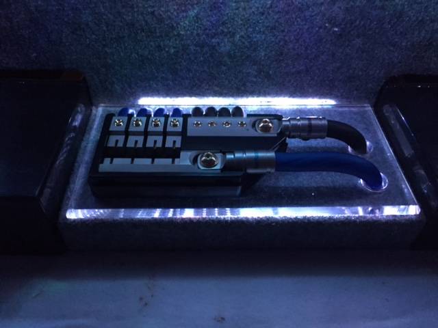

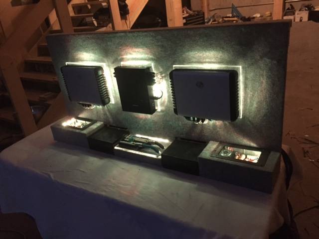

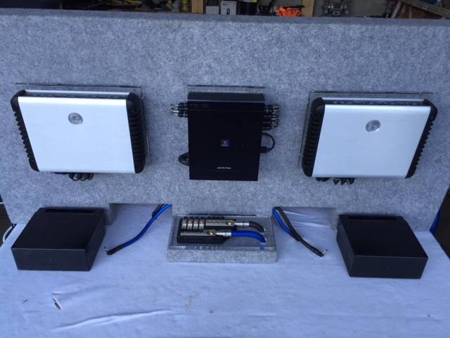

Where did you find that distro block? That is a really nice looking piece.
Also I assume you're not going active because you already need 6 channels. Those frog x-overs seem to use really high end components though.

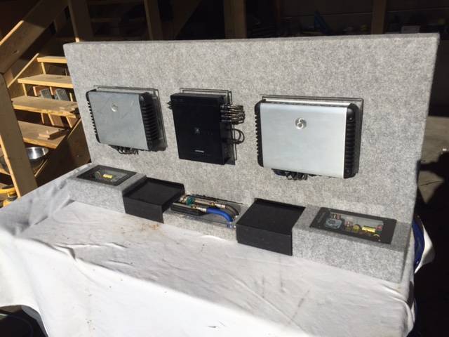

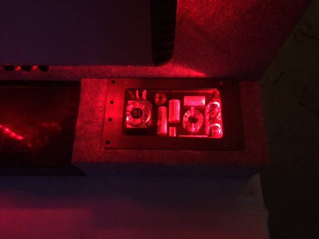

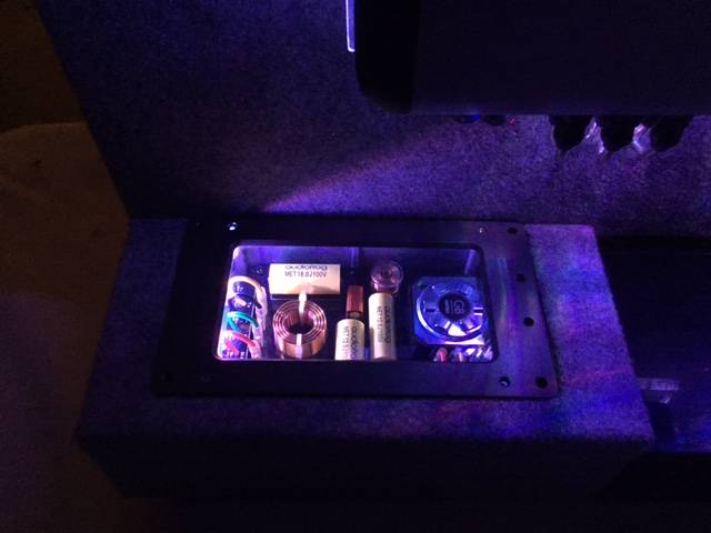

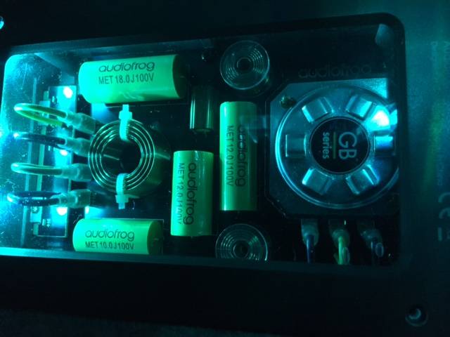

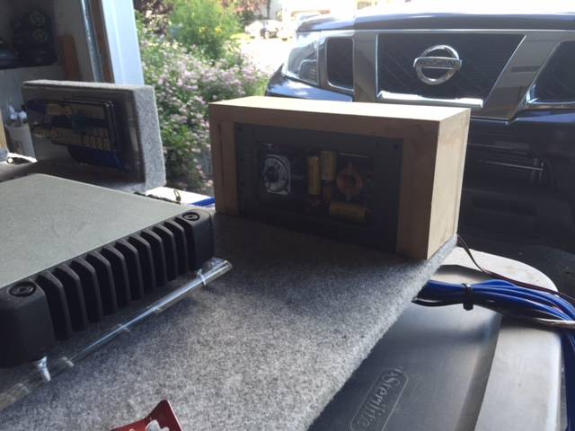

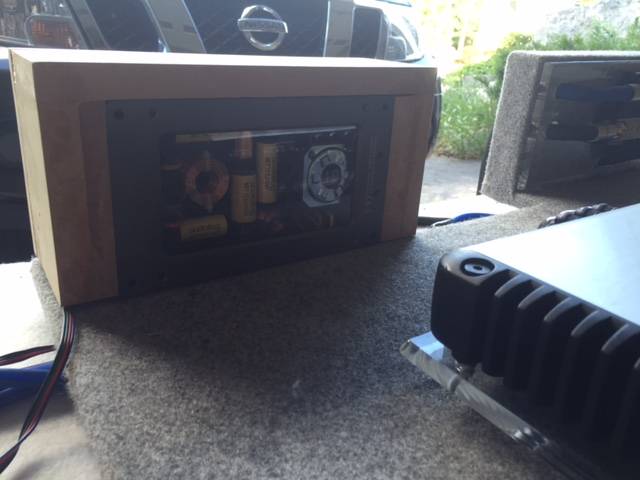

The distro-block is an older Streetwires model CBM-44 or something like that...pretty sure they don't make them anymore but there are a few similar products on the market. I am going mostly active...the only passive units will be the GB crossovers going to the GB25's (which I'll add later) and the GB10's. The plan is to do active (8) channels from the DSP; front high left, front high right (GB tweets), front low left, front low right (GS690's), center GS42, rears left & right GS62's, and sub.
...but I have the GB25's....and they would sound nice in a 3-way (with the GB10 and GS690)...so I figured I would install the crossovers and pre-run extra speaker runs for when/if I add the GB25's. So adding the crossovers and GB25's to the front high left & right would do the trick. The crossovers are beefy as Hell...BIG components.

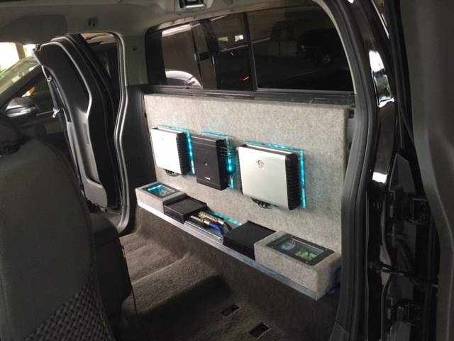

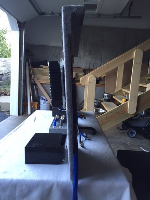

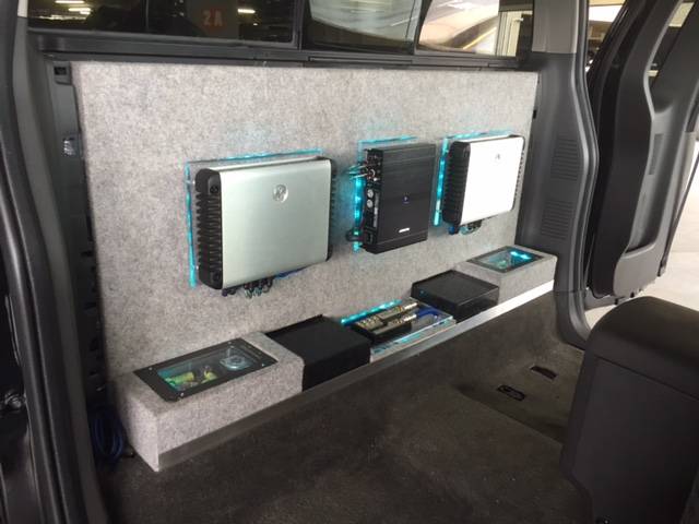

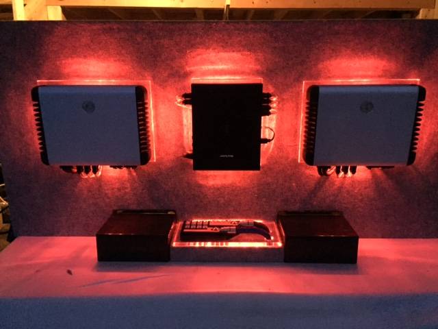

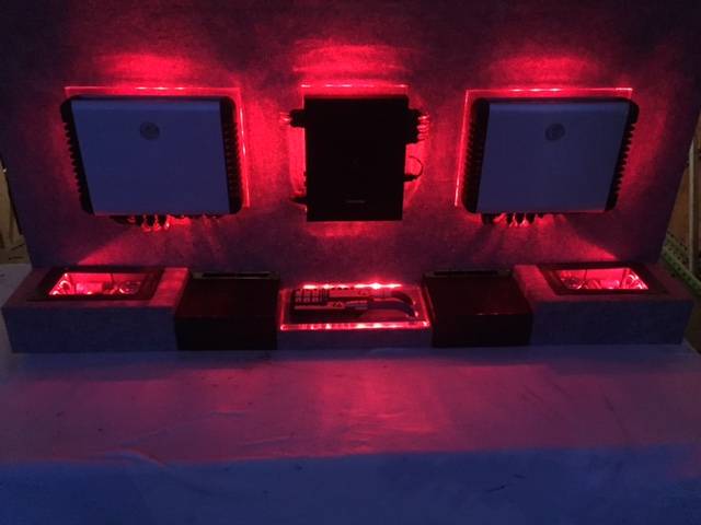

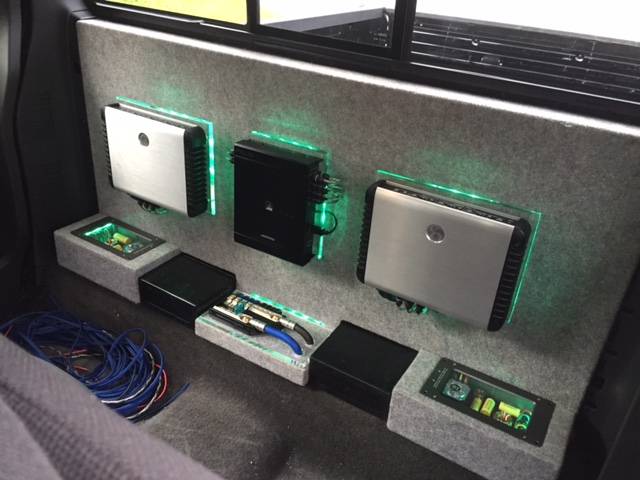

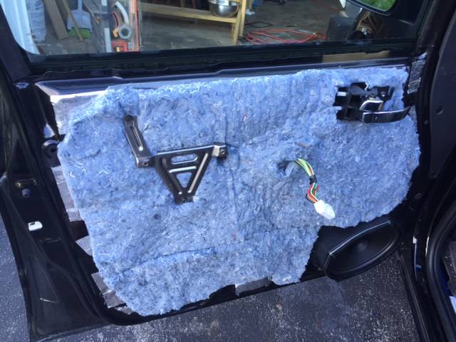

I was able to get quite a bit done over the last week or so...

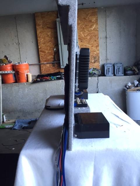

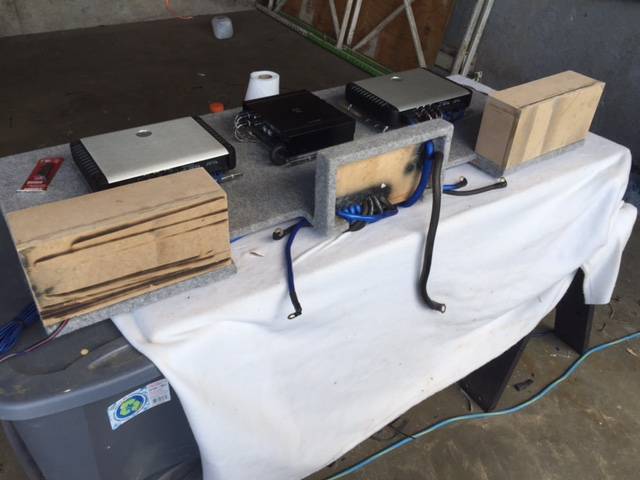

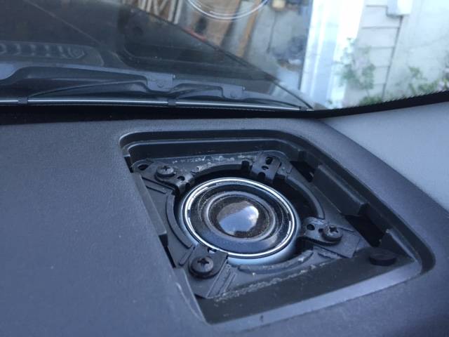

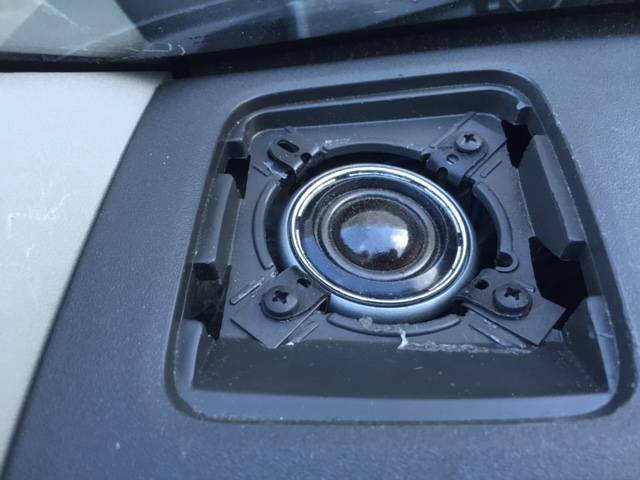

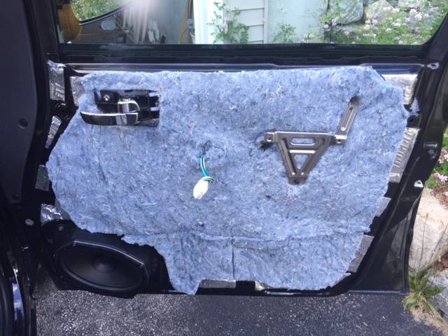

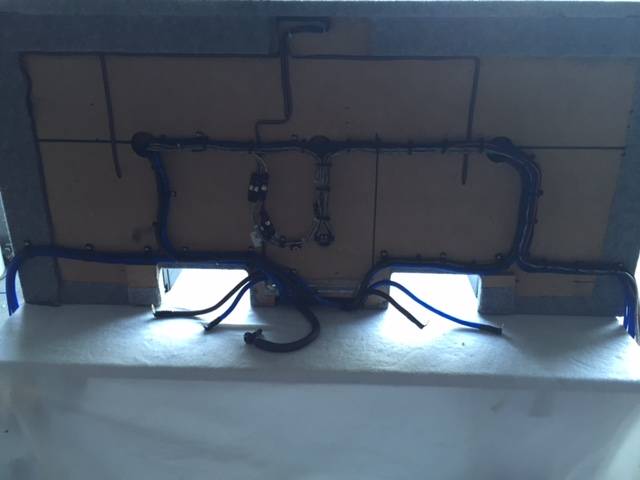

I was able to finally mount the equipment rack to the back wall. All wires have been run through factory channels, even the 0gauge power wire. The under-hood is done, the factory HU outputs have been integrated with the RCA's for the processor. Center channel wired-up and secured. Tweeters mounted and wired. Front door 6x9's wired, and an extra set of speaker wires run into each front door for possible GB25 midrange addition later on. Front door got additional sound deadening material. The rear speakers were replaced and wired. And finally the RUX was mounted in the overhead console.
I got a few pics...nothing too exciting though.
Your cat is somethin', bro. The only cat I would let lay on my subwoofer, lol. Lucky he's cute.
The work is looking phenomenal, keep the pics coming.

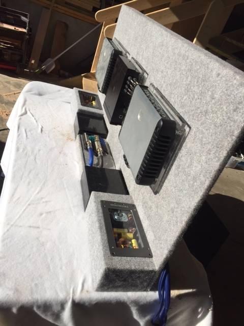

Different kitty in this picture...but you should recognize most of the subs...you owned most of these actual subs at one point or another. //content.invisioncic.com/y282845/emoticons/smile.gif.1ebc41e1811405b213edfc4622c41e27.gif

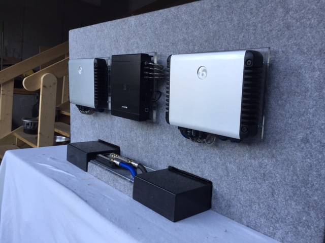

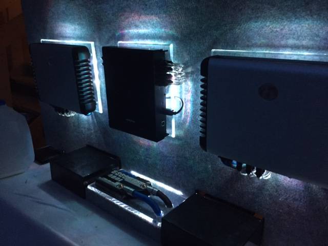

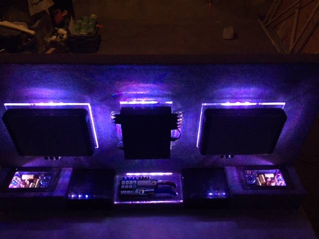

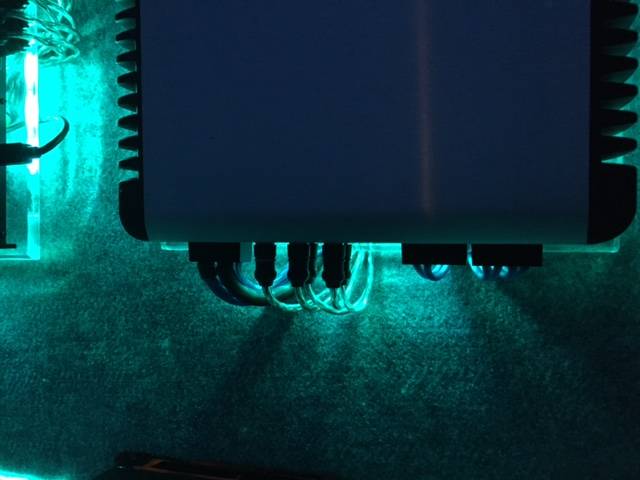

Added a strip of angled aluminum across the bottom to finish things off and keep things aligned...it matches the JL heat-sinks quite nicely.
Looks nice with all the wires run and out of sight.
