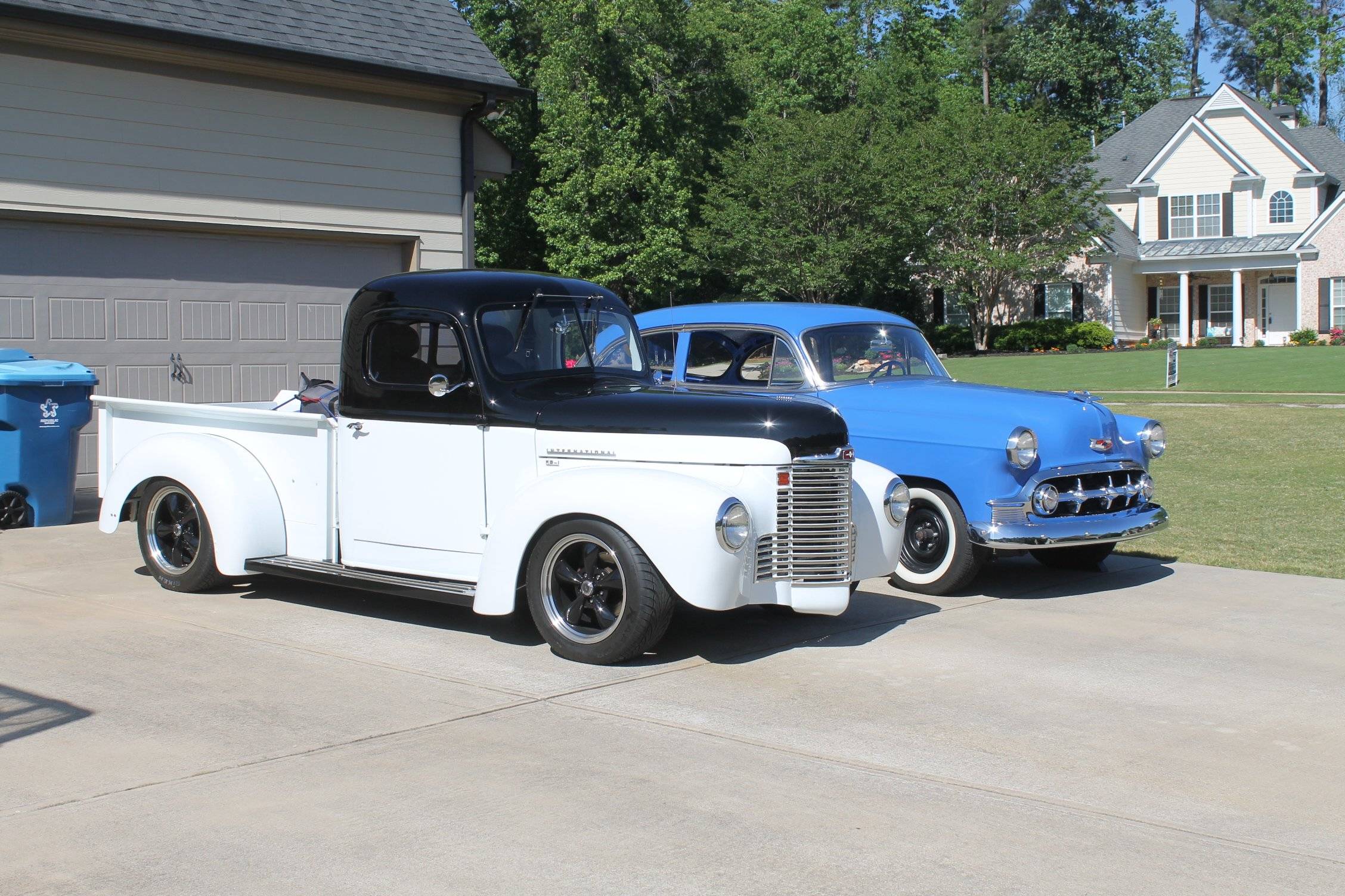

Again to understand, a 4 channel amp with subwoofer pre-out. I would connect the front and rear speaker outputs from the Pyle unit to the preamp, then there would be outlets for the front and rear speakers and also a place for the underseat subwoofer to connect L & R ? The saying you can't teach an old dog new tricks is pretty much true...I'm 74 and struggling with this..we had AM radios with one speaker when I was young. lol My son owns the 53 Chevy in the pic and has a custom $3000 setup that resembles the old face on his head unit. Mine will never sound like his but I can't hear as good anyway. ;-)

My only question is why the International and not a Chevy pick up? Just kidding beautiful truck.
I had a '54 Chevy pick up that wasn't nearly as nice as yours that my Dad bought me the day he found out my mom was pregnant.
Traded it for a '75 ***** am in '02 when I got my license.
