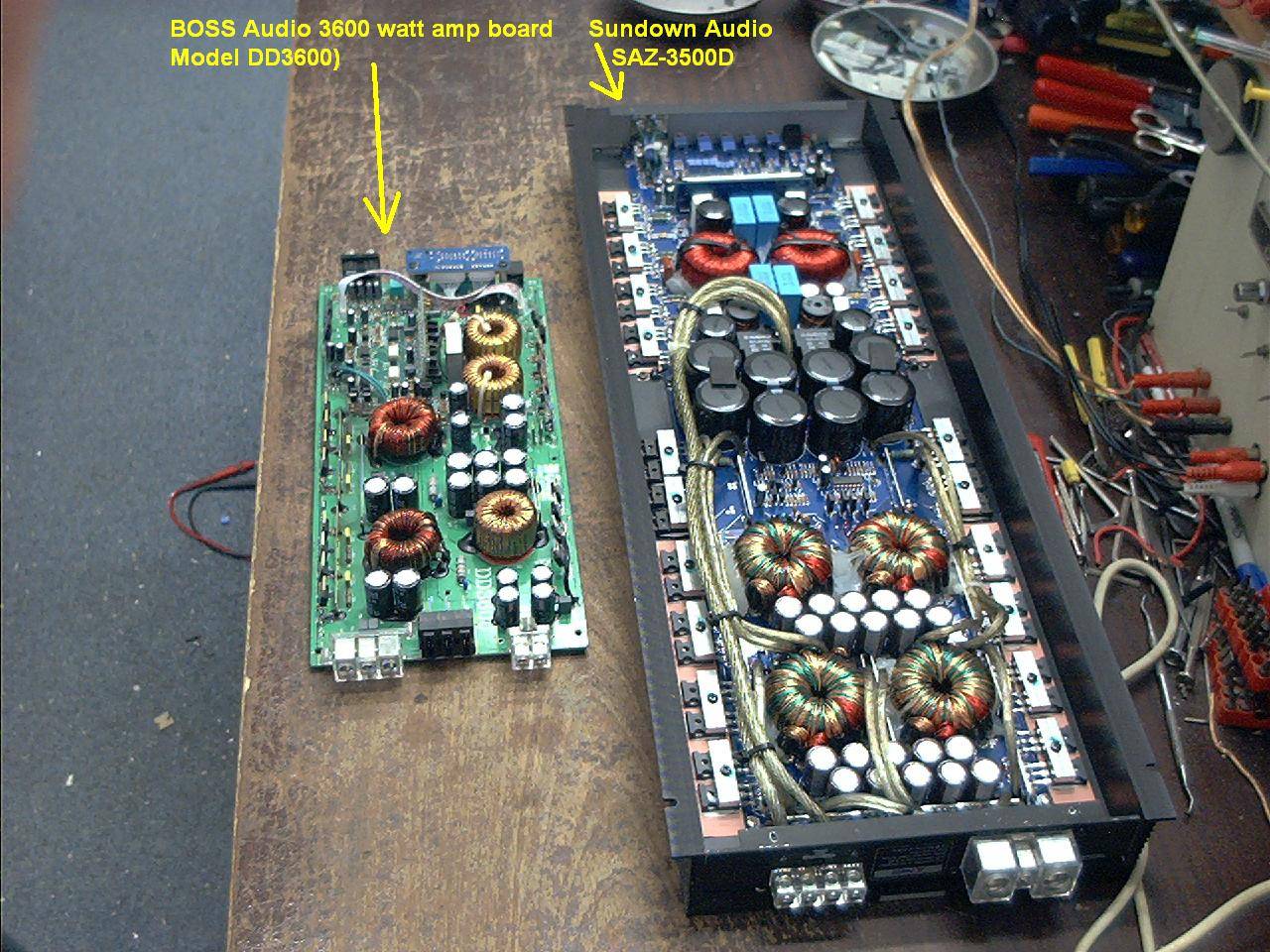

There are a lot of brands that vastly overstate what their amps put out. They can pretty much just make up numbers. A good rule of thumb is you get what you pay for. There's a reason Sundown costs a lot more than Boss:
