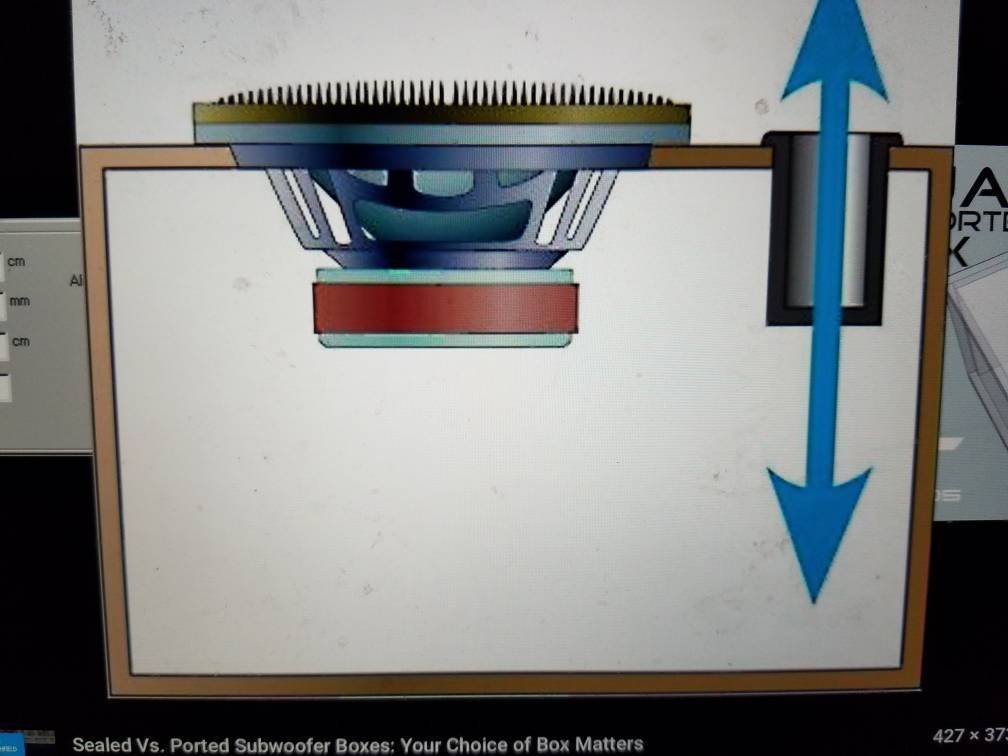

Awesome thanks guys...Ported or sealed ?

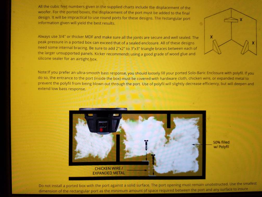

What's the difference in these two ported boxes which is best? Seems like a very subjective question I know but, thank u
Sent from my SAMSUNG-SM-G930A using Tapatalk
1st design is a standard aero port.
2nd design is slot but its done pretty godamn stupid one lol. So much impeded airflow all around.
1st design is a standard aero port. 2nd design is slot but its done pretty godamn stupid one lol. So much impeded airflow all around.

With aero ported enclosures why do you want to have the port on the side vice front facing the same as the woofer? Someone told me that it had to be side facing
