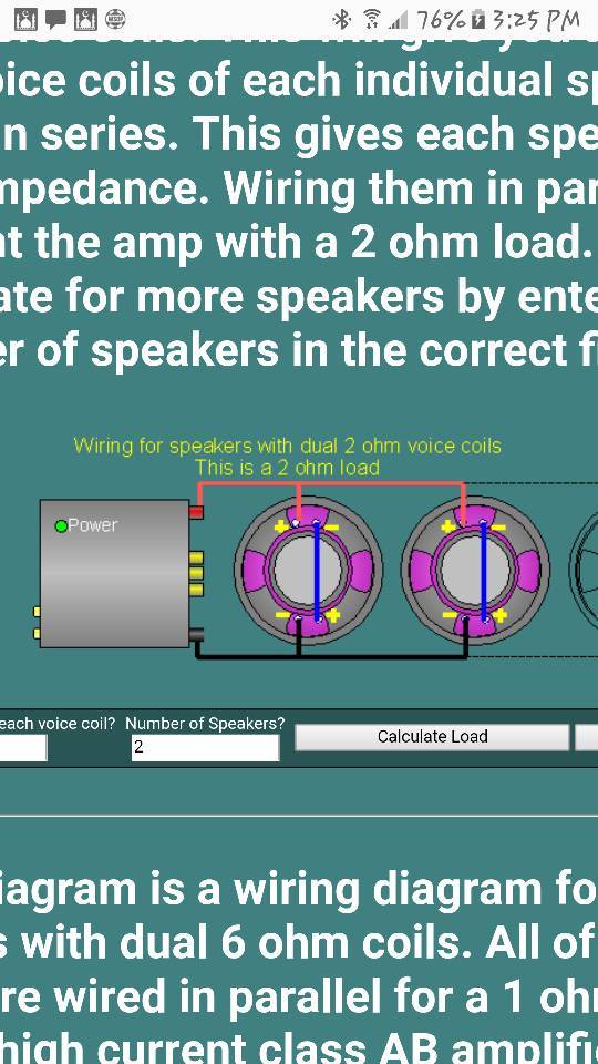

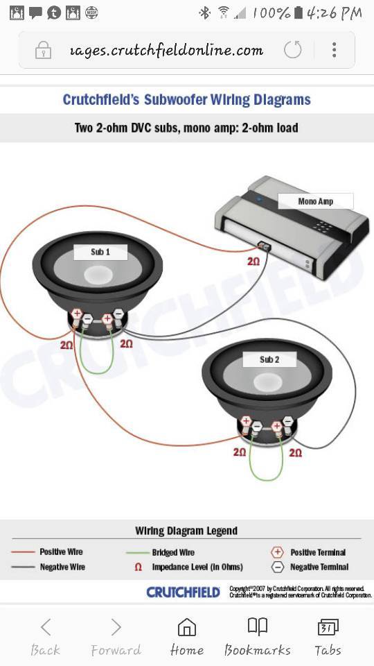

1000w amp mono supposedly is 700watts at 2 ohms / 500 w rms dual VC subs 2 ohm /
Wired like this to create a 2 ohm load. My noob question is ....Do both subs get the 700 watts? Please forgive me folks just looking for a straight answer.

You're going to wire at 2ohm or .5ohm

op gonna have a tough choice on finding an amp at 1/2 ohm.
