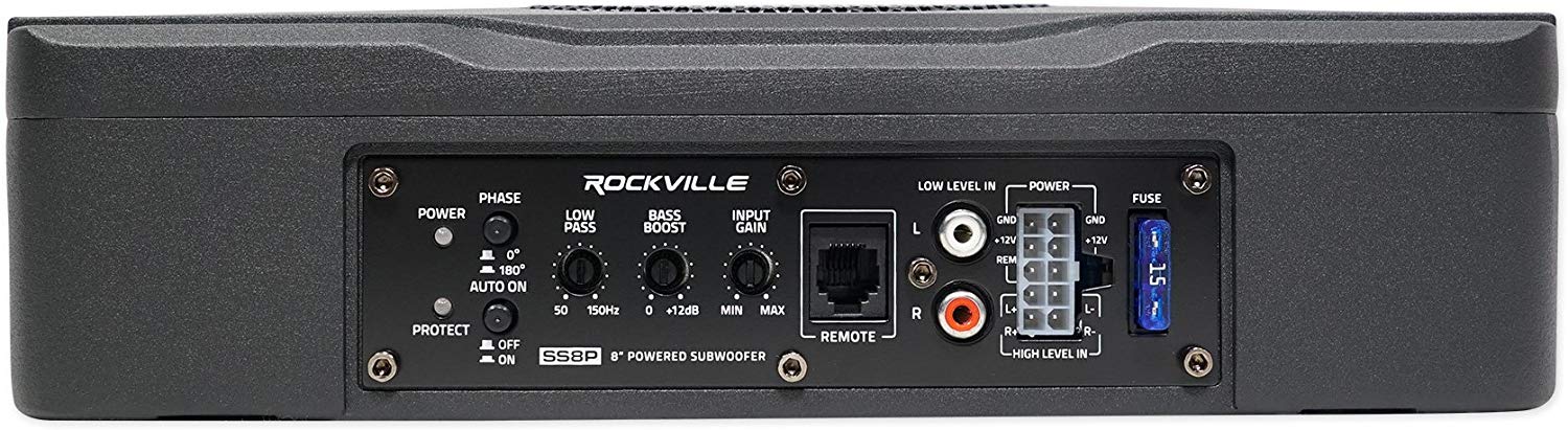

Rockville SS8P 400 Watt Slim Under-Seat Powered Car/Truck Subwoofer Sub+Amp Kit

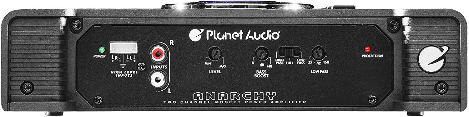

Planet Audio AC600.2 2 Channel Car Amplifier - 600 Watts, Full Range, Class A/B, 2-4 Ohm Stable, Mosfet Power Supply,
Bridgeable
The HIGH LEVEL INPUT. I did not ground the middle wire. When I tried to ground to the chassis (same ground point as the 4 gauge wire), the buzz gets very bad. Should I ground this wire back to the HU or HU chassis?
Bridgeable
