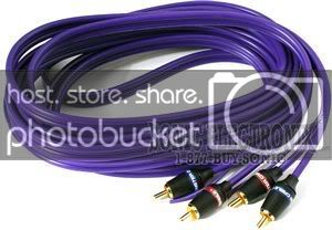

OK after trying everything imaginable I tried what should have been one of the first steps.
I tried some cheap home audio rca cables and it worked like a charm.
Cheap *** Scosche cables FTL!!
That's the last time I go with low budget patch cables.

I think I'm gonna go with these Monster cables.
I usually am not a fan of Monster in the home audio world because there are so many cheaper high quality brands, but it looks like they offer more reasonable prices in car audio, and I know that they will have high quality connectors.
http://www.sonicelectronix.com/item_7162.html
