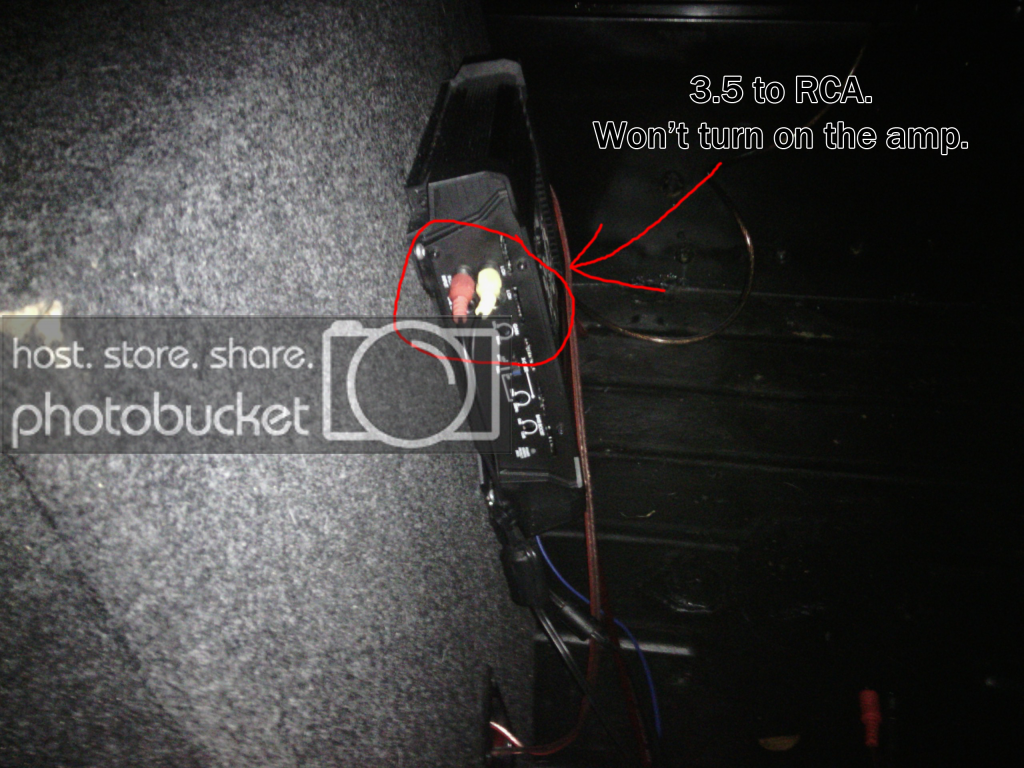

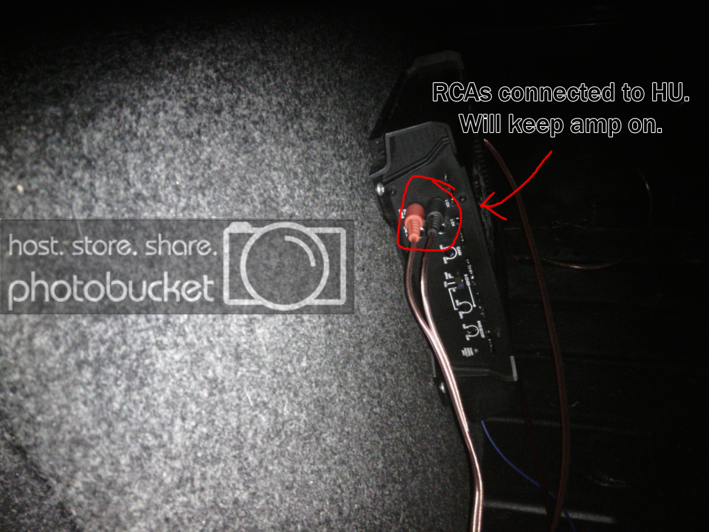

Yeah I know my key and HU were on. But my amp doesn't turn on(or won't turn on) if it doesn't have RCA cables connected.
The RCA cables from the HU to the amp will keep the amp turned on but my 3.5 to RCA cable doesn't keep my amp turned on.

No no, the remote wire will turn the amp on but only if it has RCAs plugged in.
Hmm? o.o
That is odd. I've never messed with an amp that worked like that. You can try fooling with different sources to get it to power on, just to make sure everything with the amp and sub is working right.
Tried using a RCA to 3.5 converter on the original RCA cable (cable that I'm using from my HU to amp) and didn't keep the sub on... Argh. It's like it has to be connected to a headunit but I dunno. :x
