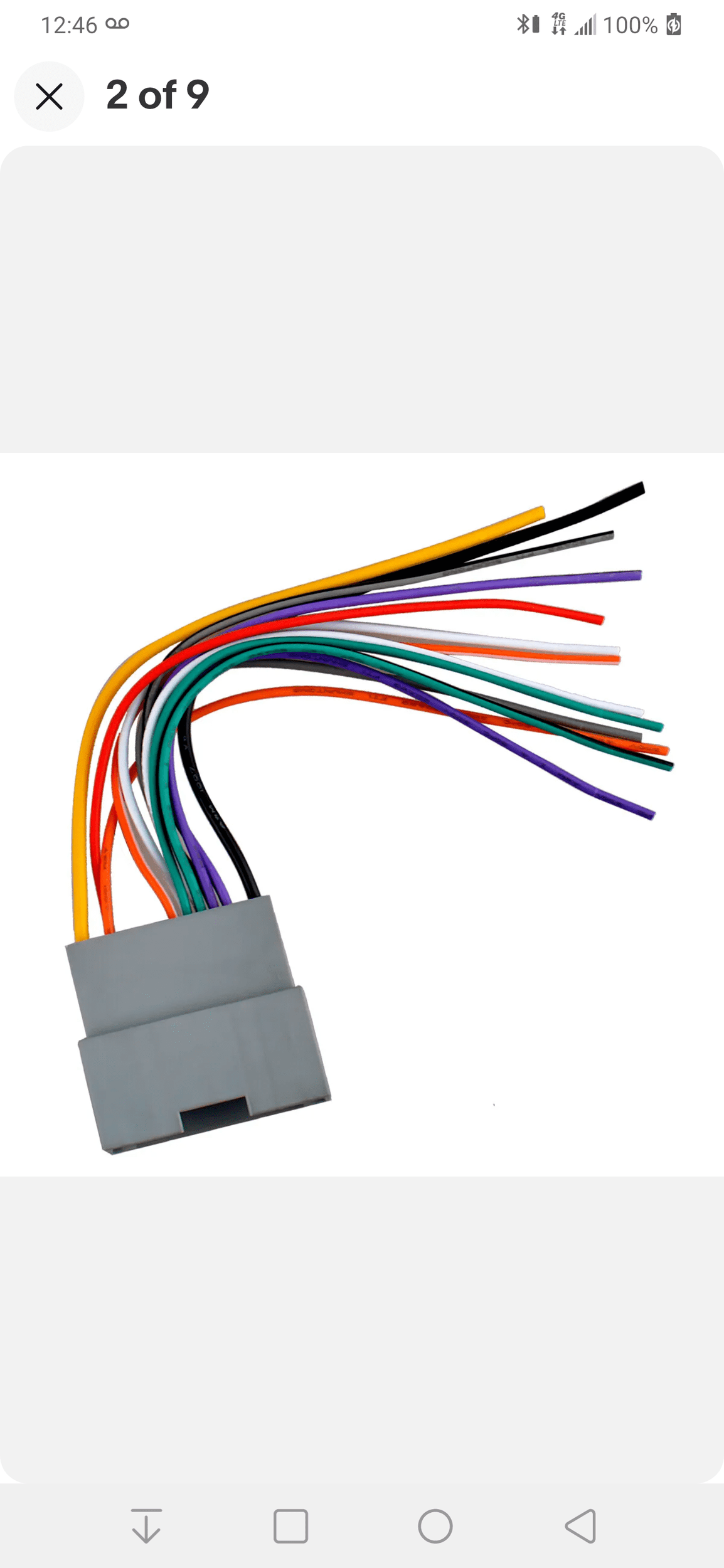

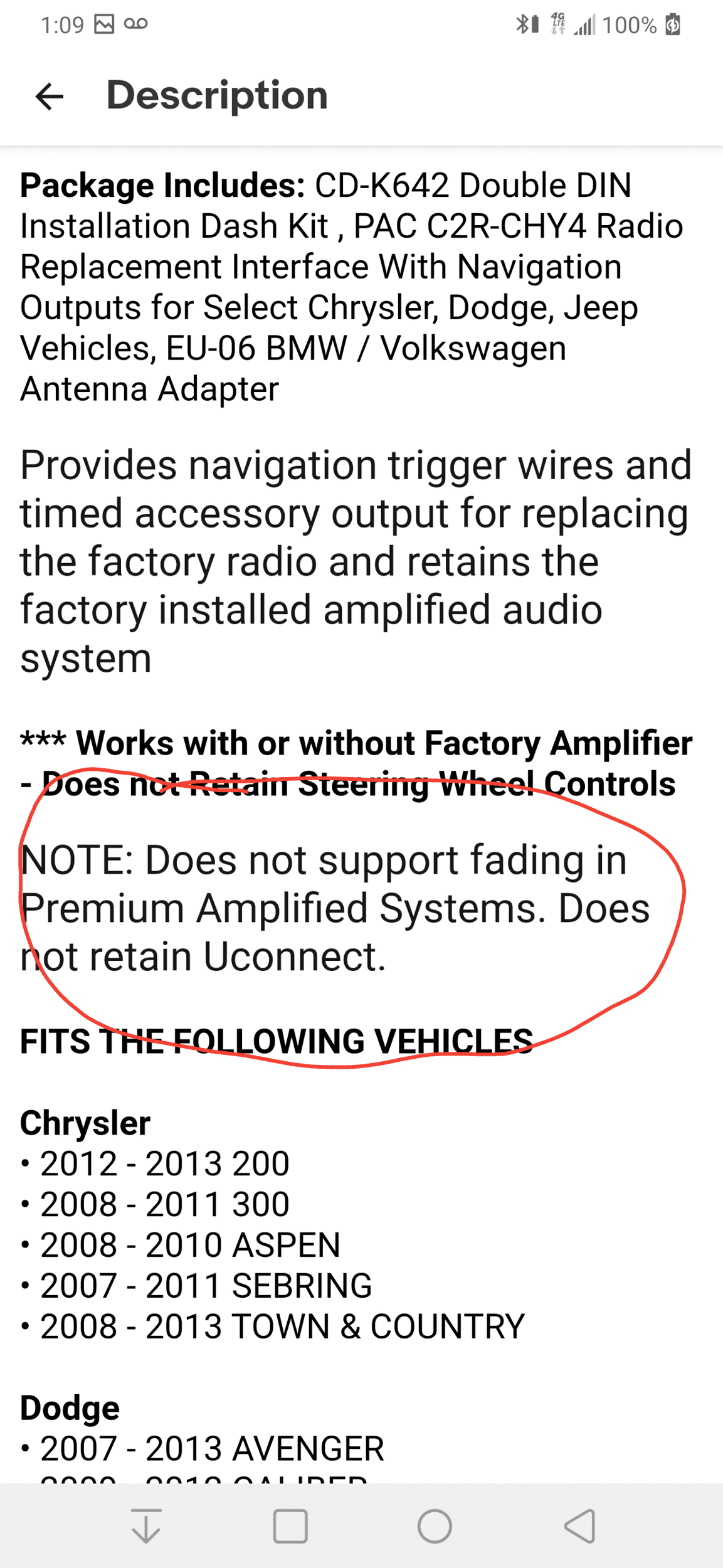

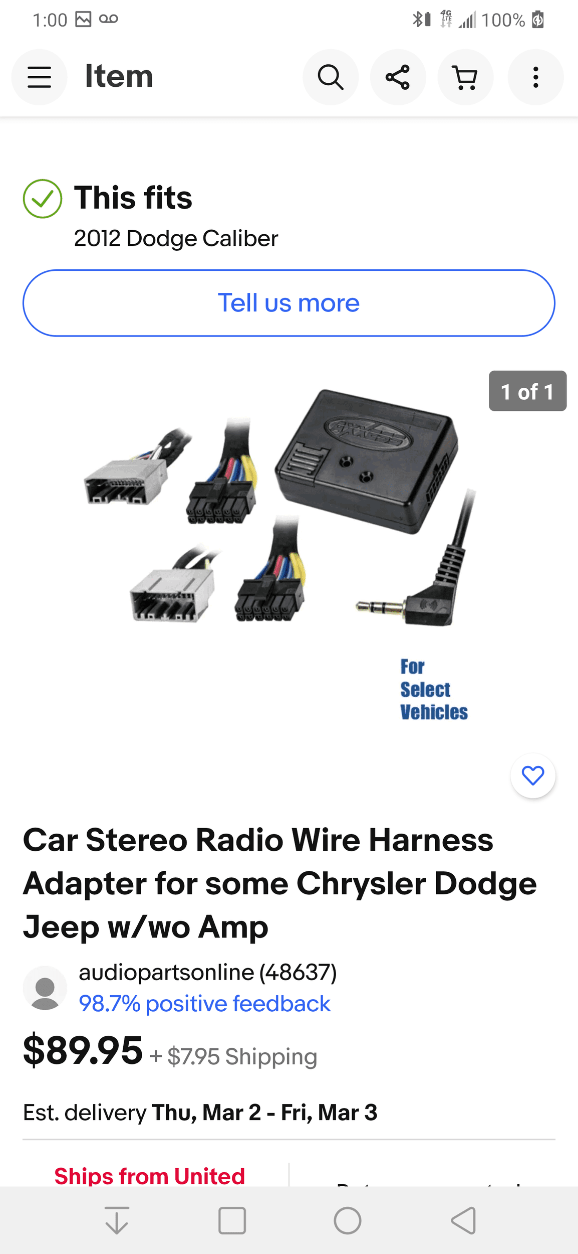

So another adapter i
I just saw this on another adapter -->
So you may already have this adapter. Bummer.
Ok. Since it is a factory amp, the installer should have used an aftermarket radio install harness. Basically it wires into the new radio, and then just plugs into the car's radio harness. No need to cut wires on the car. With this adapter harness, the RCAs are not used and you keep your fader control. It looks like this -->

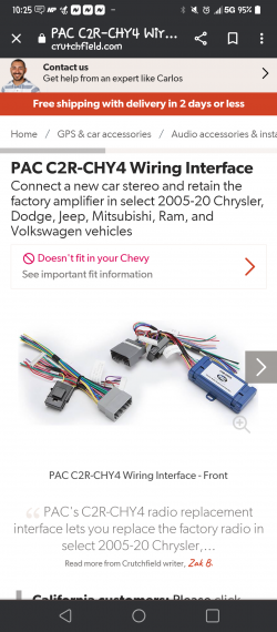

Since your car has factory a amp, it would have to be a more specific harness, something like this -->View attachment 47370
That looks different what I have. I certainly don’t have that adapter.

unfortuanally as mentioned before it isn’t possible to get fader with this setup: Pioneer radio 4 way output and a factory amp on board. They didn’t get it working. I had some hope that they could do the job because they are a specialized radio installer. I have to live with it or buy another amplifer wich will cost me enough to decide not to do. It works with an original radio but than i don’t have hands free wich is a must.
