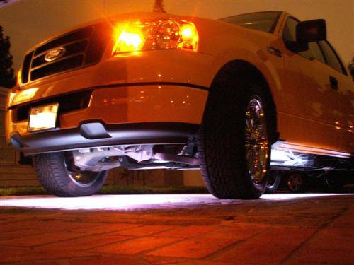

5) I believe that there is an AUX button on the Viper remote. Does this mean that I can not only start my car, but also turn on an auxiliary device too? I was considering adding some white under body neon-like LEDs lights under the car to guide/light-up around the car at night. I would love for when I hit that button, the white LEDs come on (of course I'd need them off when the car is actually on to avoid a ticket). I know I'm getting carried away but that would be a nice feature. All in one remote //content.invisioncic.com/y282845/emoticons/smile.gif.1ebc41e1811405b213edfc4622c41e27.gif.
Thanks so much guys. I hope to have my Contour secured in no time.
Here's a pic I found off Google of what the white LED's would look like:
This picture pertains to question 5.
I think this would be great when approaching my car at night.

5)I think the 5901 comes with at least 4 aux outputs, and yes, they can trigger anything you want. Keep in mind tho that everything you add is going to add to the price of the install so be prepared.

The 5901 has 4 ext outputs that can be configured to validity, latch, latch reset w/ignition on, and timed 1-90 seconds..I would put the undercar lights on one of the outputs and set it to timed, so that they won't stay stay on and drain the battery.
