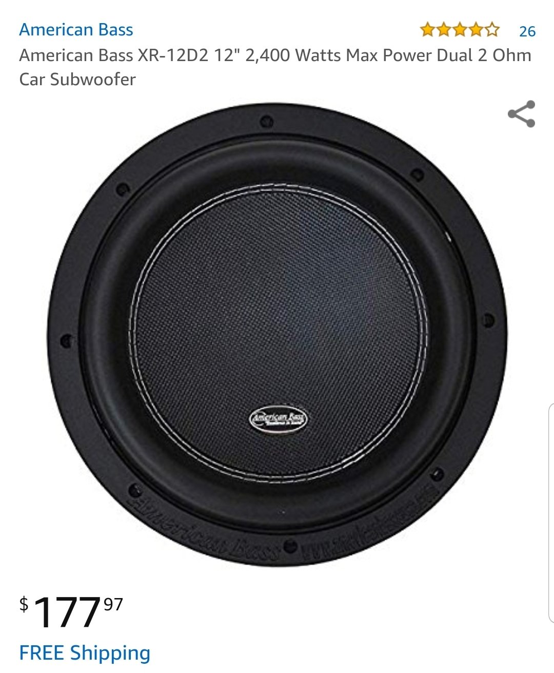

American Bass XR series is a good budget minded sound quality alternative sub. There is no way I would pay that much for a W6. Or a Dayton.

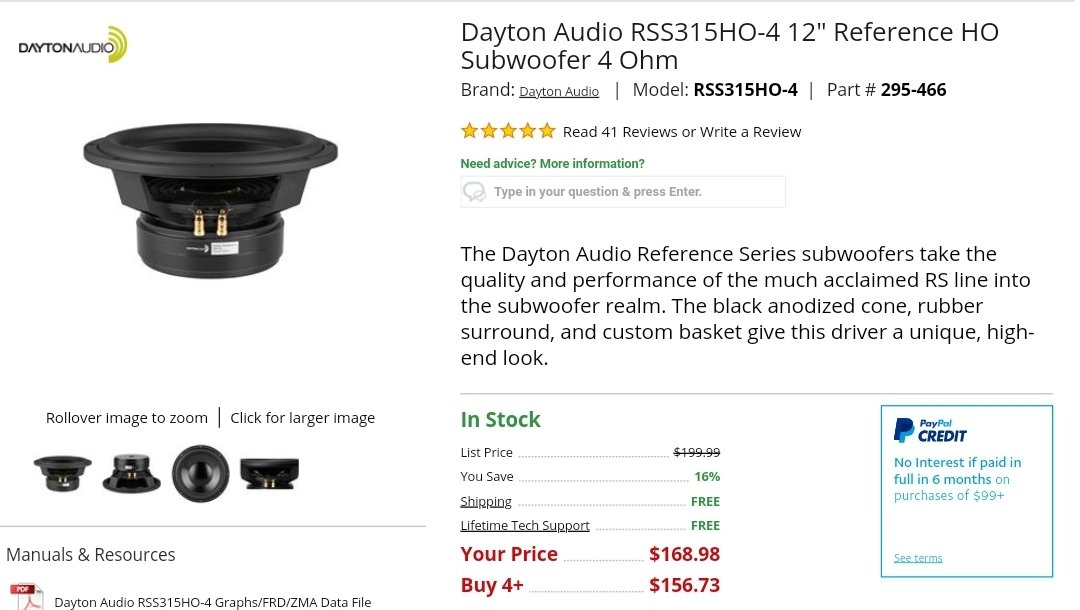

I would run the Dayton if your looking for sealed an sq. Or pick up a used w6. That's the only way I ever buy JL audio is used. I wont buy JL new, not worth that price. But used you can get some good stuff for good prices

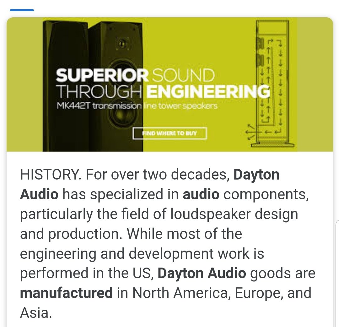

What makes you think the Dayton isn't designed for car use? Hertz is Italy. Dayton engineering and development in the US. Your Hertz is a single voice coil 4? The Fs is better on the Dayton and dual voice coil.
