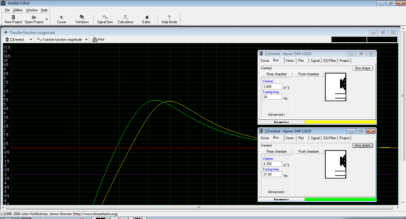

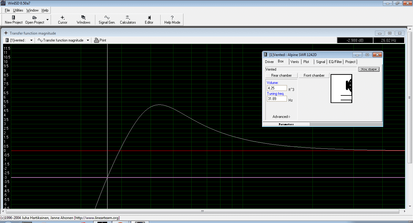

IDK what that higher tune will do to the low end response in a smaller box and how it'll react with the port area you used... here is a much better curve that will go under 30hz easy and still peak in the 40's... it's 4.25ft3 net with 47.25 in2 ported 23.75" long... it's a 31.84hz tune and it looks like it'll do just fine as a daily. You have a crossfire vr 1000 correct?.. I accounted for around 1200 watts as well. If you got the room I'd definitely go with or close to this... it should sound nice.

i was playing around with some port tunes (30 to 40) and 34hz was the most balanced one to me...

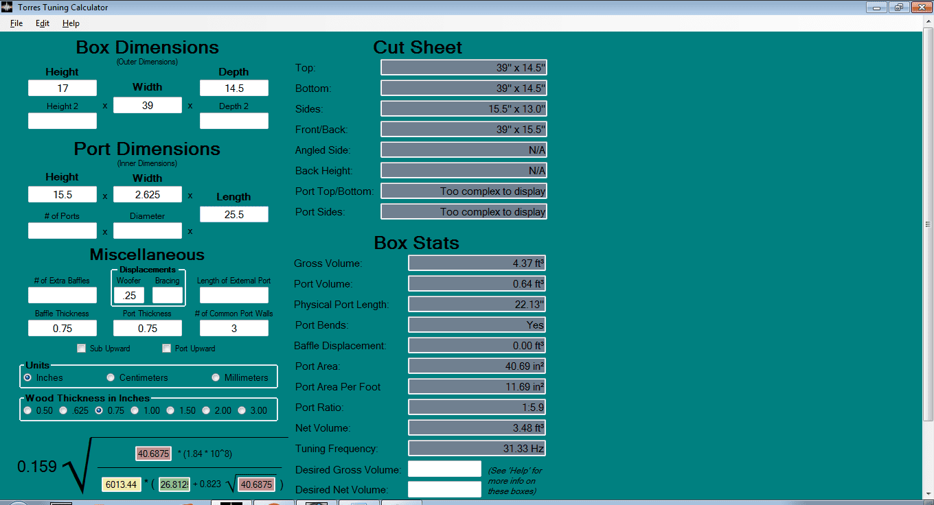

win sd give-me 29in length for a 34 hz tune but the calculator from the site The12volt.com give me a length of 31in, the same Port Width and Height on the 2 calculator´s, 3cf box and 3 x 15.74 port to a 34 hz why the diference?

Width - 39
Height - 17
Depth - 14.5
and those are the measurements of this box 3 cf + port

32-33 hz tune with your space...
I'd tune as low as I could and use the most airspace I could get... only 45 the port bend and brace the rest with dowels (top to bottom, front to rear)... that's me though
