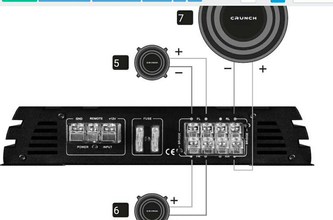

I have both subs in a ported box with each sub having their own wires

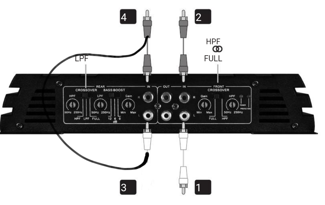

I forgot about the remote, I'll wire that after work today. What about that single sub output on the back of the hu? How do I run a single rca from that to a 4 channel amp?
I bridged the amp too, using all 4 channels for two subs. I used my LoC in the mean time to run the rcas but there is only 1 input for each channel on the amp? That confuses me. I put 1 rca into channel one and the other into channel 3 for now. I mean I'm getting bass from it but I don't want to mess anything up
I forgot about the remote, I'll wire that after work today. What about that single sub output on the back of the hu? How do I run a single rca from that to a 4 channel amp?I bridged the amp too, using all 4 channels for two subs. I used my LoC in the mean time to run the rcas but there is only 1 input for each channel on the amp? That confuses me. I put 1 rca into channel one and the other into channel 3 for now. I mean I'm getting bass from it but I don't want to mess anything up
The single sub out can be "Y'd" into the rcas for the low inputs on the amp. I'm not sure if the amp was designed to bridge the high pass side for a sub. From the images I saw, and what ive read... it never shows it being wired that way. Not saying that it can't, but you probably won't get the full potential from the sub on that side. You could run them both, (i think) but one for each rear channel instead of bridged. Here's a pic of the input side.

That crunch amp isn't much different than a boss amp.... It's going to be pretty weak. The Y cable will help get a signal to the 4 channels for sure. As for the Pioneer amp, it's probably stronger, but without knowing the model it may not work with what you have for subs.
