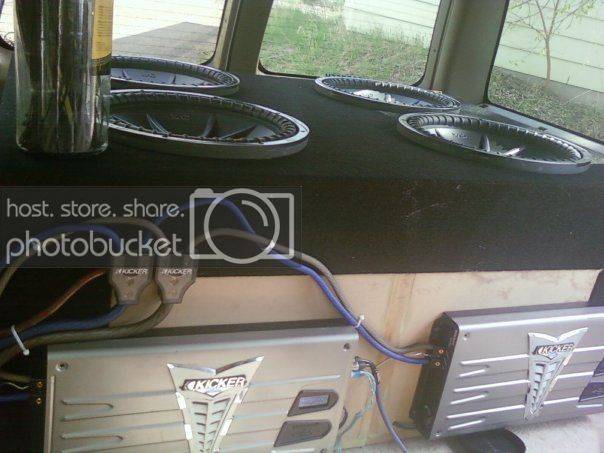

my cousin will more than likely be charging lol. my last set up i threw any money at he installed and built the box. that was 4 15" kicker cvx's 2 kicker 1250.1's 1 700.4 all kicker components with an alpine double din i dont remember the exact model. but i know that system sounded pretty awesome looked good and had 0 issues. he charged 500 for the box and install. thats the only pic i have of it. th box was huge it was taller than my rear seats. ports were on the back facing the doors.
that was all in this truck.
