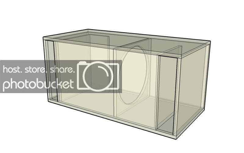

alright, now I ordered a beefy built custom TC9 via David at RE and that is in the works to getting to me. Had a little hang up with it, but I don't mind as I saw something I really liked //content.invisioncic.com/y282845/emoticons/smile.gif.1ebc41e1811405b213edfc4622c41e27.gif.
The TC9 will have:
  1. MT Soft Parts
  2. Carbon Fiber Dust Cap
  3. Flat wound alluminum VC
  4. Triple Stiff Spiders
  5. Thick *** leads
  6. 15 inch 4 spoke top assembly
  7. Chrome Push Terminals
And I went to my boy 80Inches here on the forum for a little design work. Hooked me up with a design of course and got me a parrallel tuned Band Pass fit to specs of the sub.
Specs are:
  1. Front Chamber- 2.37 @ 65 hz
  2. Rear Chamber- 3.2 @ 35hz
It has a 7 decibel peak at 43 hz, which should be good for my style music as its not a quick roll off around that at all really. Thanks again 80! Should build it rather quickly.
