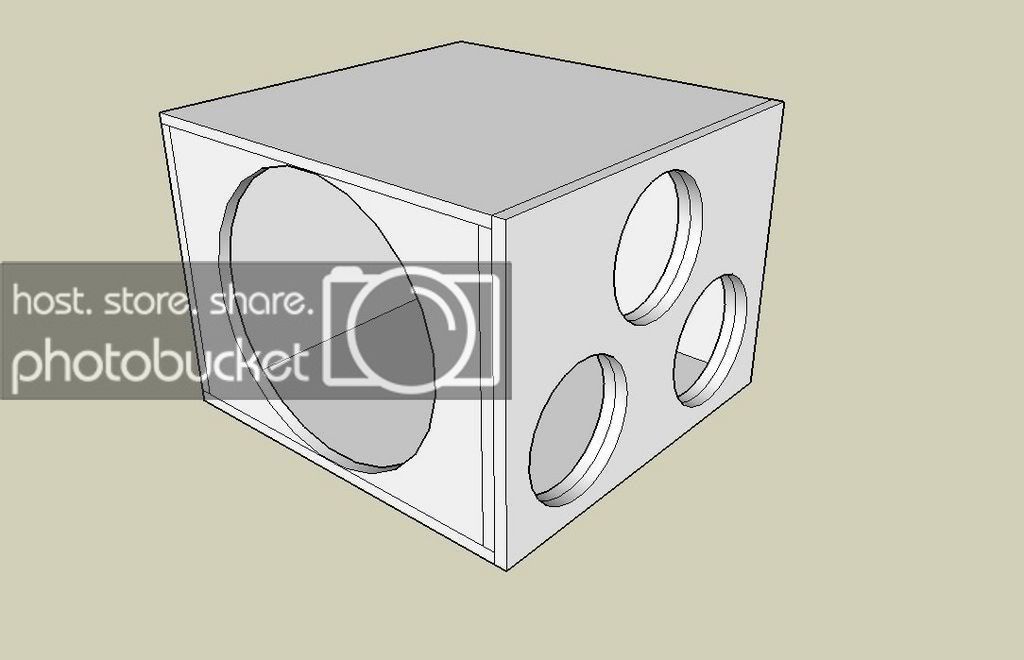

New Box in Progress
vetkilr
You will probably want to double your baffle and provide some extensive bracing. I just recently did a box for (2) Massive DMX 15's and those things are extremely heavy. I assume the aeros are going to be mounted externally right?
Yes external.
I have the sub and yes it = heavy:D
What size box,what power,what tuning and what power on them?
I hope those ports are not going to be long, it looks like you can hit the basket with just about all of them??
Yes external.
//content.invisioncic.com/y282845/emoticons/wink.gif.608e3ea05f1a9f98611af0861652f8fb.gif
ya go a lil bigger 3-3.5... iv messed around with that same design u have i think it was 2.7 with 3 4" aero's with multiple 15's and never could get it really loud..it actually sounded terible.. real muffled
