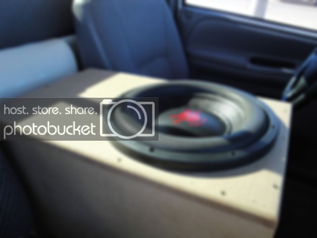

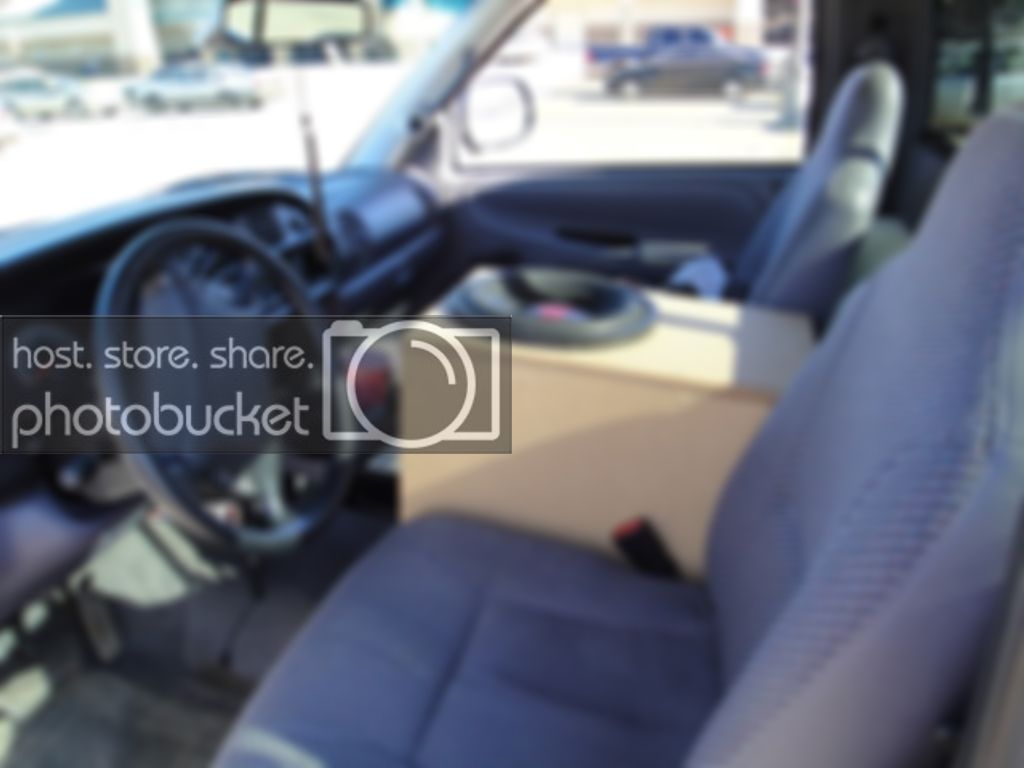

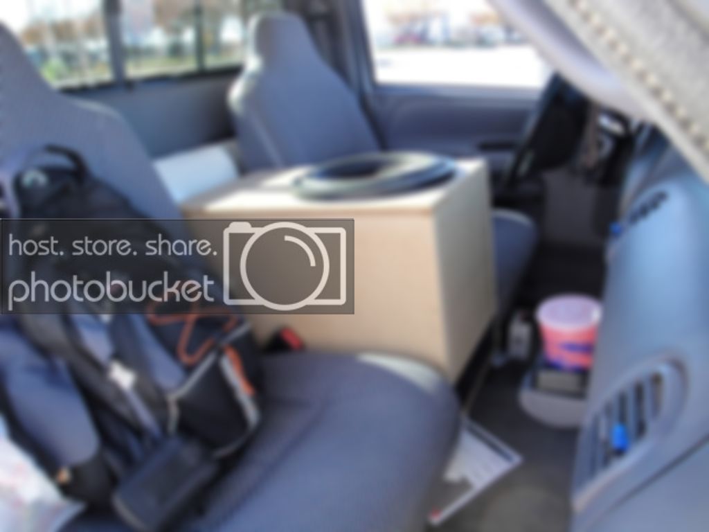

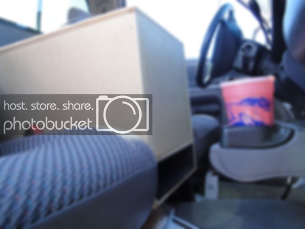

Well sorry for no build pics guys, but here's some finished ones. I bought a router last week and built the entire box with it, straight edges and all. I'm officially in love with my router. haha.. But anyway, i built a fiberglass box for my truck a few months ago back when i was in high school still, and it did pretty good on the meter (140.0) but i wanted to go a little louder without having to change setups completely. I decided to build a box to go where my center console was. The box itself is 1.9 cubes tuned to 33 hz (made for my new Fi Bl 12 coming in), but i decided to put in the DP for the time being. There was a noticeable difference in the sound and loudness of this box over my other one, but this one will only be used for competitions, or when i don't need a center seat (can't put the GF beside ya when this is in. haha) So i went and got it metered yesterday. Still peaked at 42 hz like my fiberglass box (which is tuned to 36 hz) and did a 143.5 on the TL, and a 145.6 on an AudioControl 170. Very very happy with these scores. Anyways, on to the pictures..
VID!!
And before anyone says anything, the box is actually at a very good height for resting your arm. And i can still reach everything just fine.. It does have a problem with ******* things up off the floor (sucked half a beach towel into it a couple days ago).
