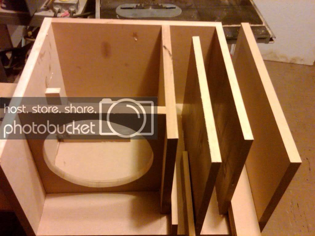

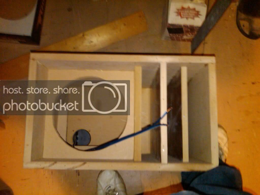

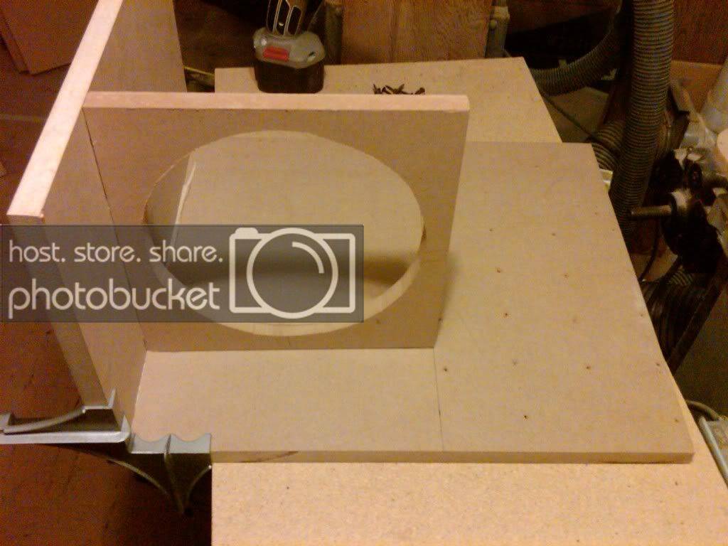

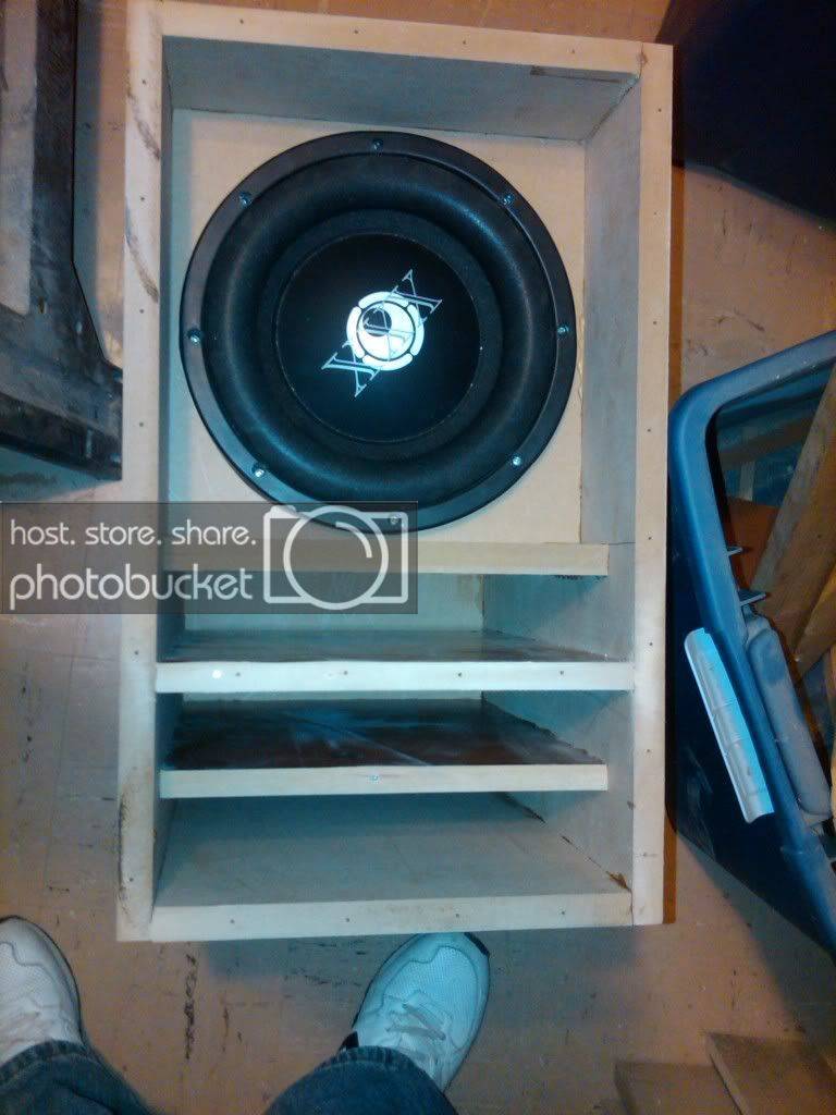

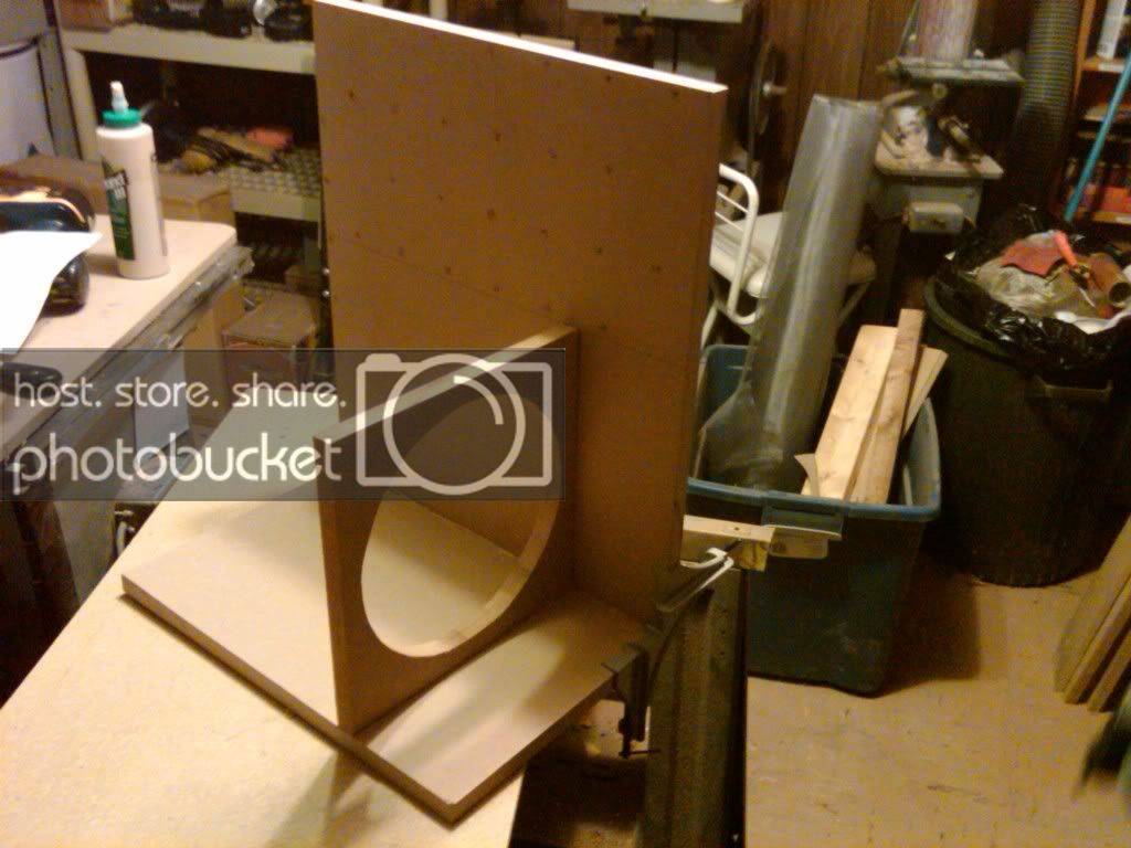

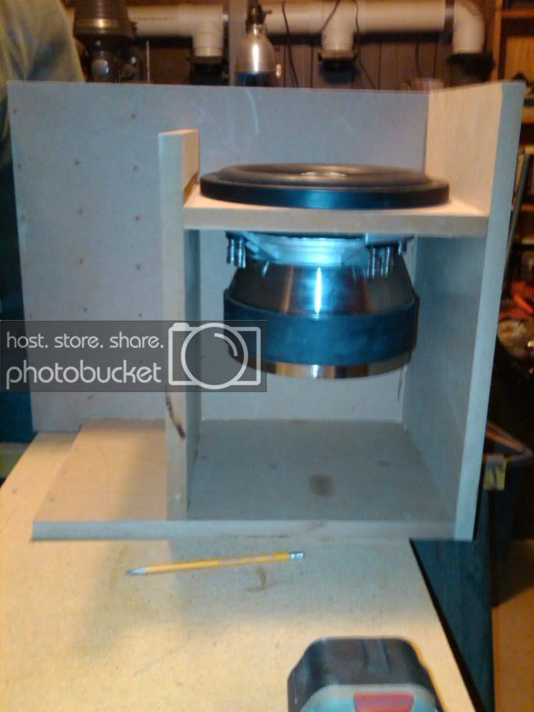

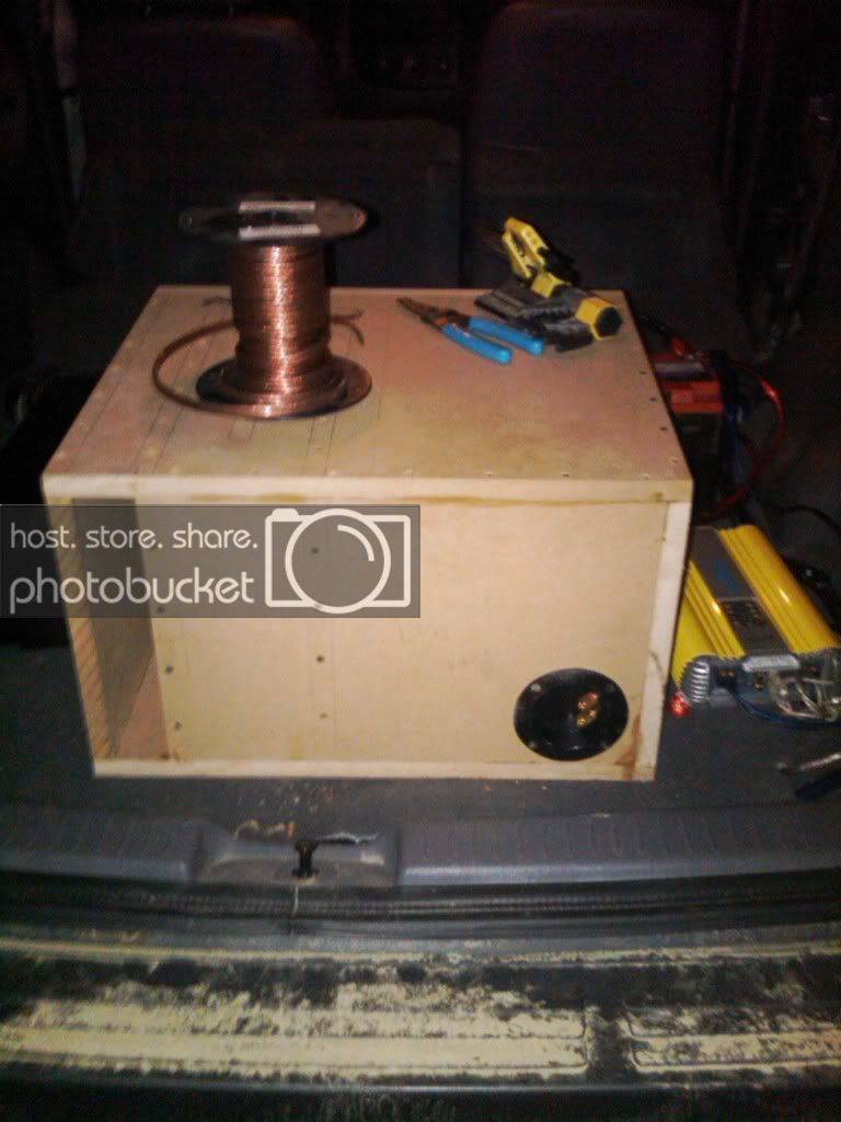

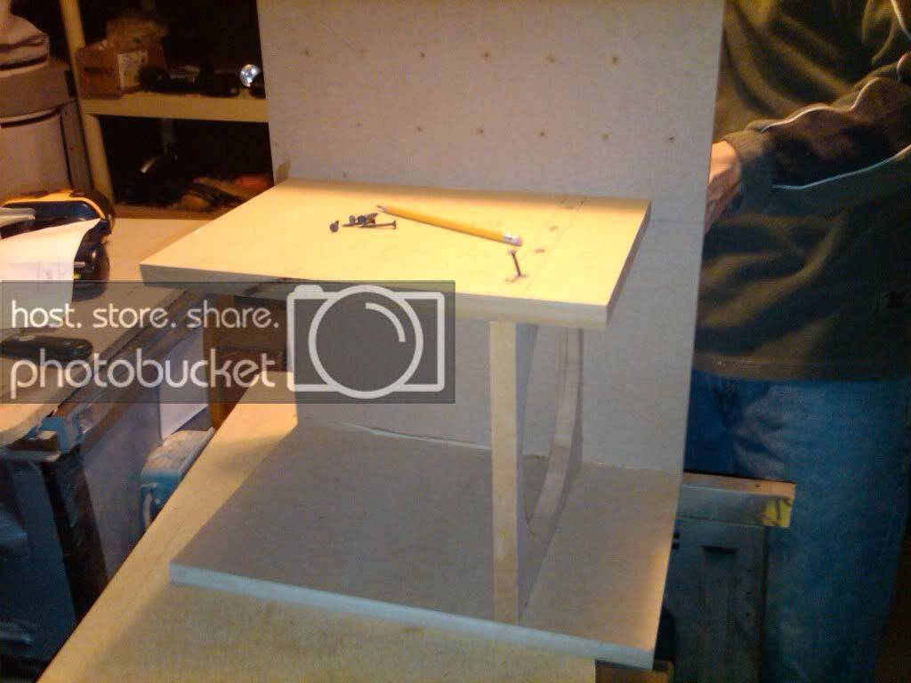

Against some peoples wishes and opinions, I went ahead and built a 4th order for the XXX. The kid wanted to build it free, how could I say no? Don't have all the measurements, forgot them at home but I think the sealed chamber is .5-.6 cubes after displacement, ported chamber is .3ish cubes and port is about 56" long giving a tuning freq. of about 54-55?? port size is 22sq. in. I forget. Curve mimicked .4 cu. ft. box but with 3-5db gain throughout until leveling off IIRC. Criticism always welcome, good or bad. Kinda crappy cell phone pics but, meh. On with the pics.....
quick test fit
i let the guy have his fun building it. It still hits the lows with authority. I was wondering the same thing, but as of now, without playing with the gains/eq too much, I can't complain. After a week of breakin it in, i'll play with it more and tell how it is

How does that design plot out? And have you measured the freq. response?
Looks like he did a good job building it, aside from the port edges not rounded. I probably would have went with more port area also.
