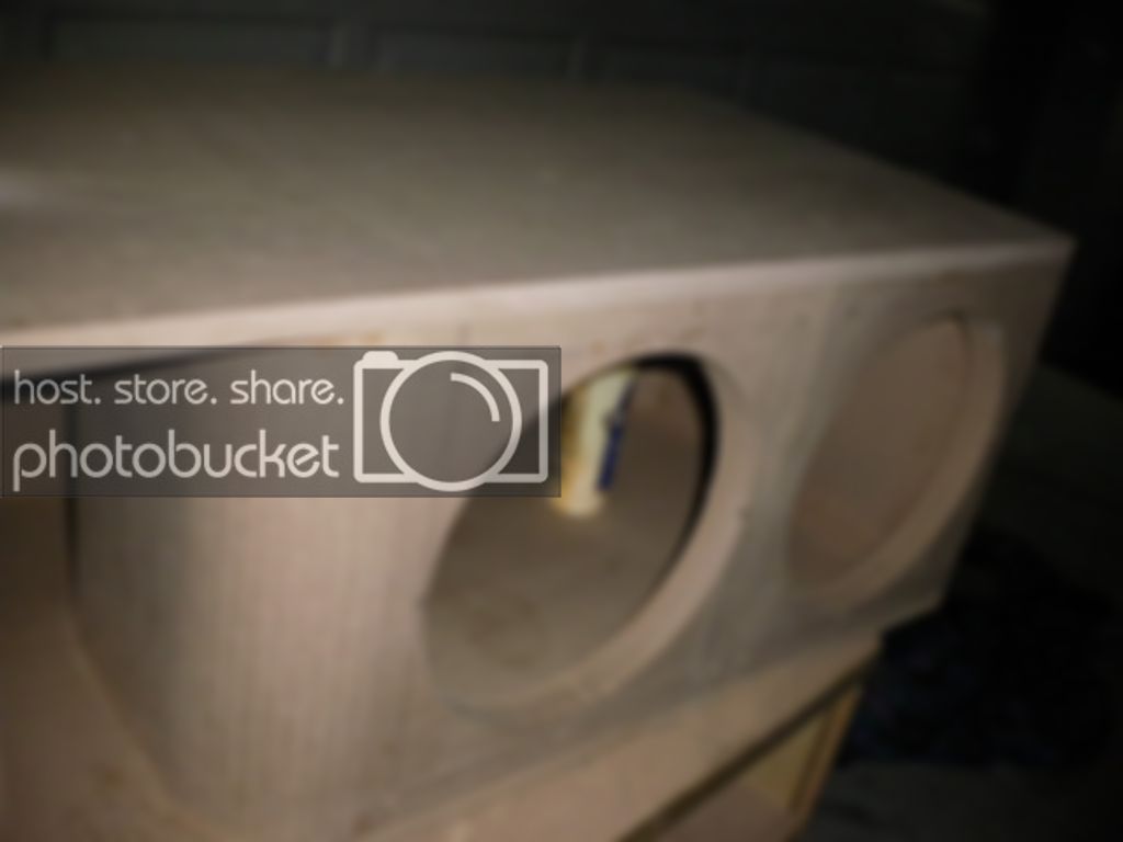

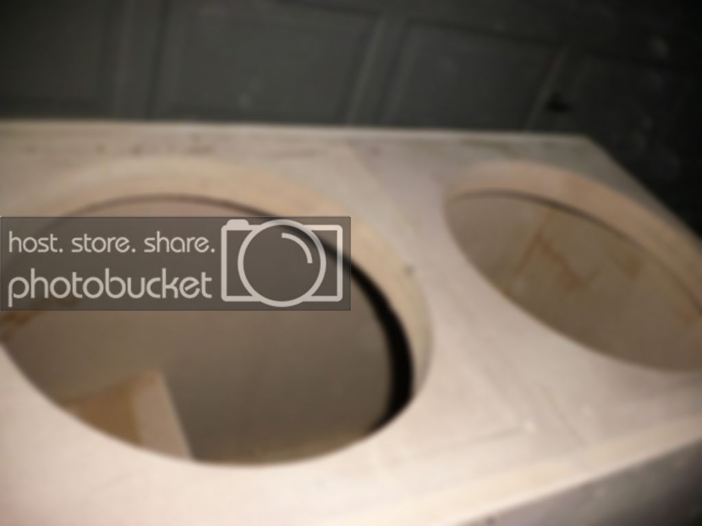

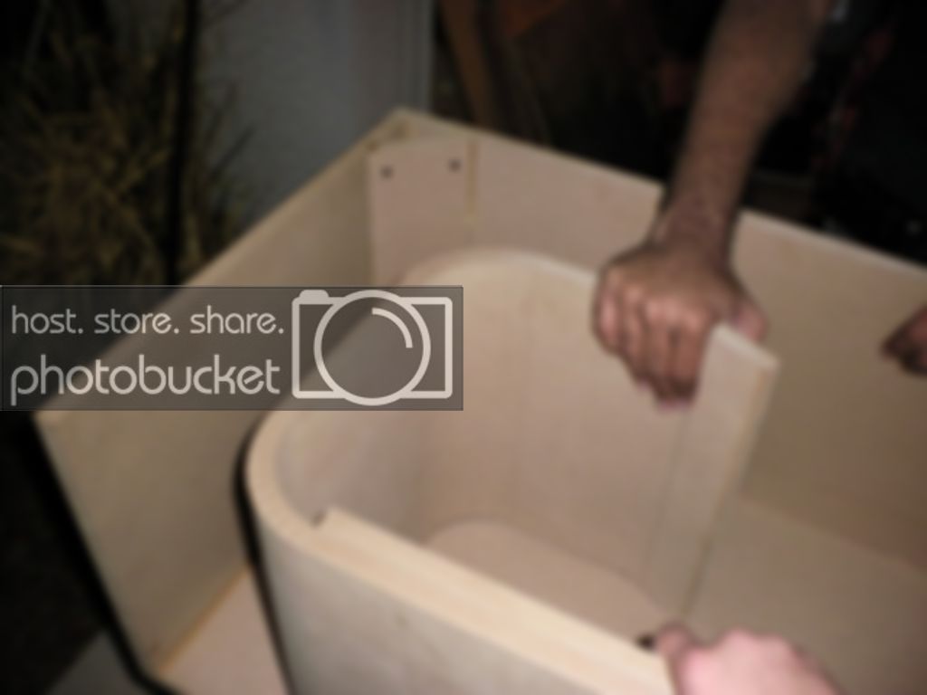

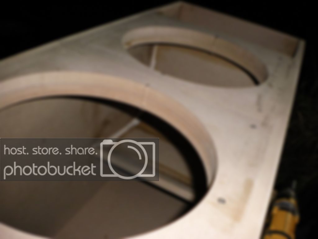

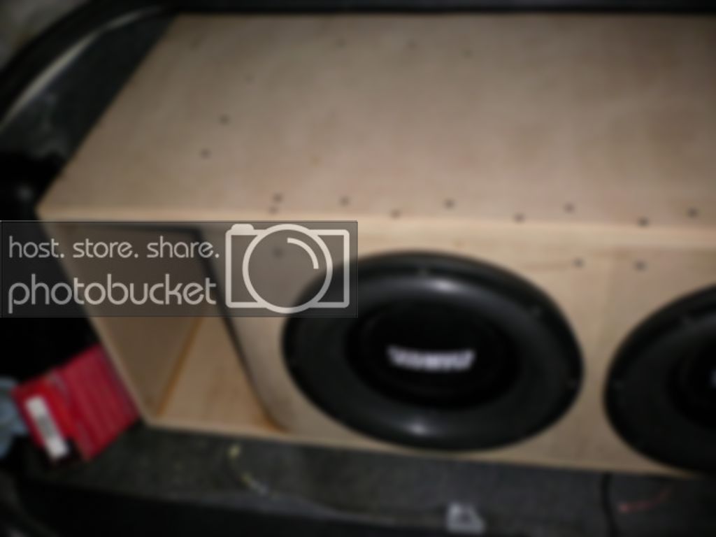

i posted it on other sites so finally decided to toss it on here

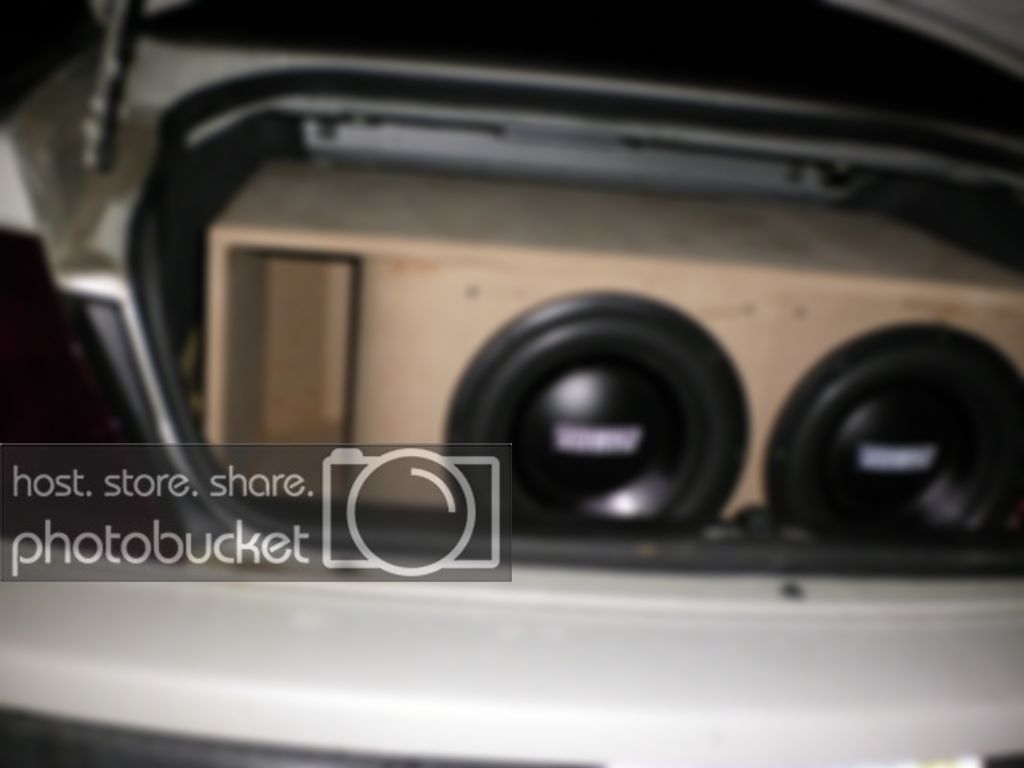

2 12" D1 sundown nightshades
2 aq 2200d @ .5 ohm each
4 cubes double baffle, kerfed port @ 34 hz

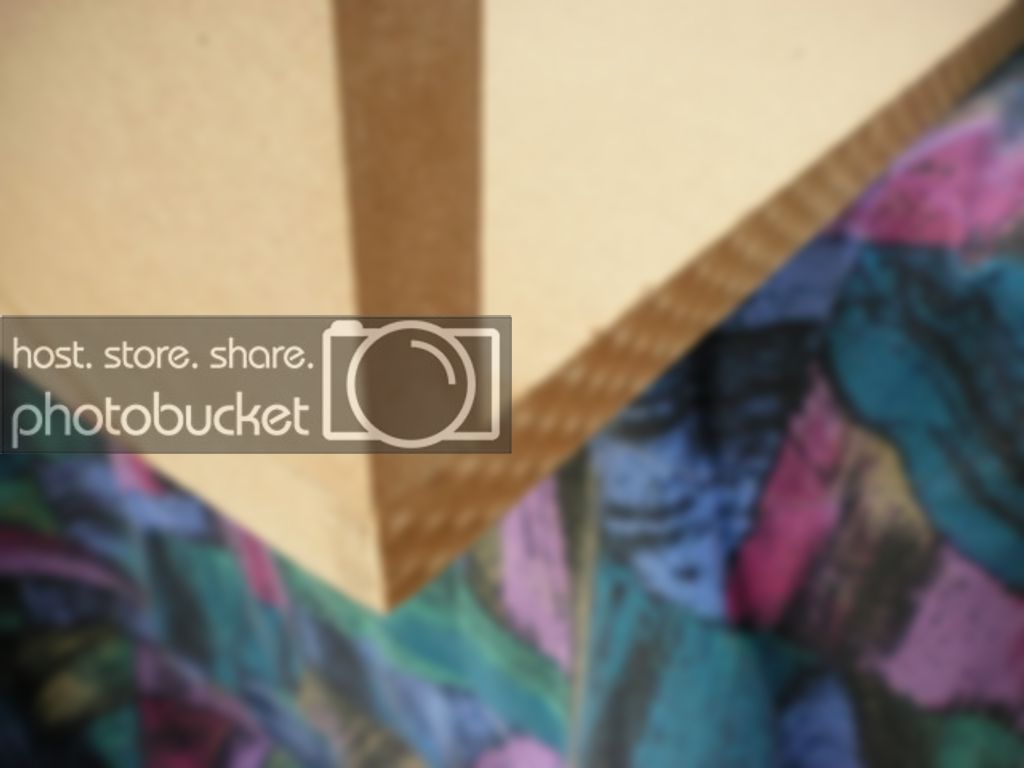

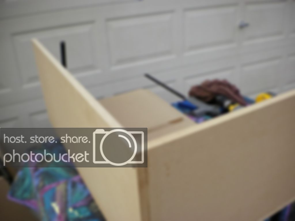

and this is a shot of the first 3piece put together with my new table saw.
holy hell this thing is accurate.

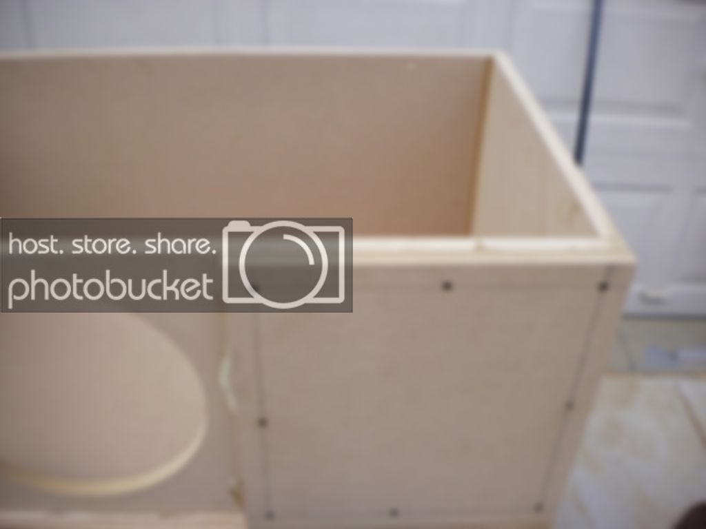

Strange looking end grain from lowes Lumber department.....

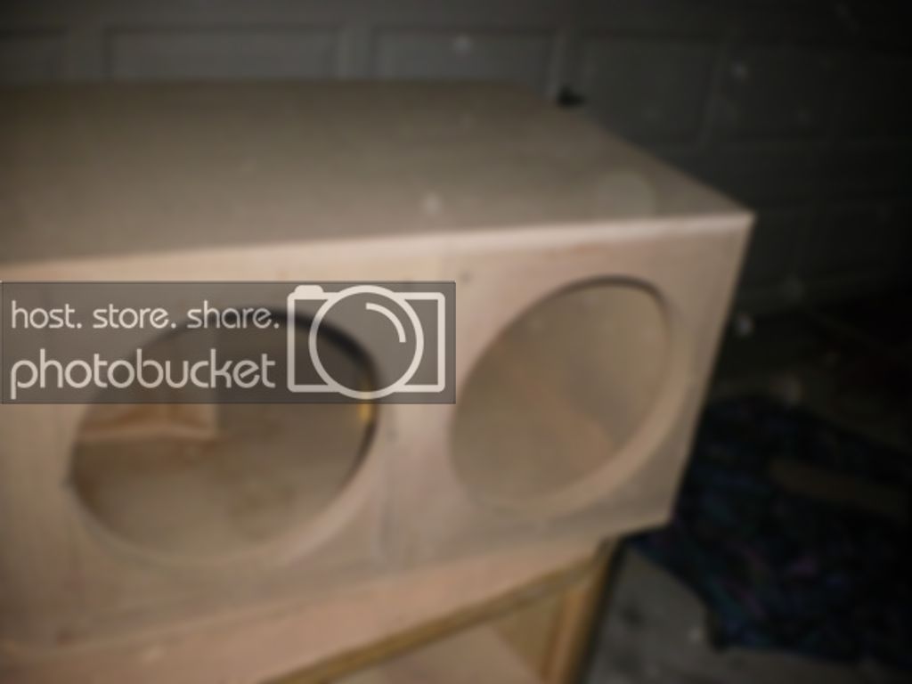

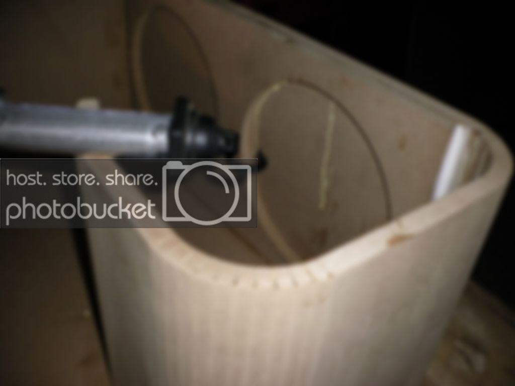

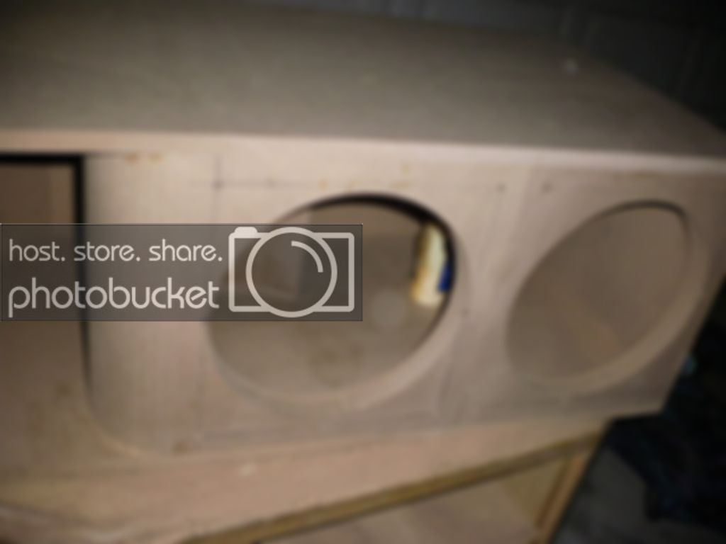

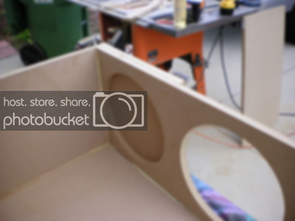

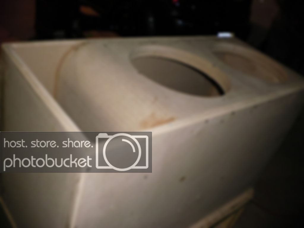

Double Baffle, Split front baffle, etc.
Edges rounded over 1/4 inch
for 2 Nightshade 12's
and 4kw
its on 1 aq at the moment and will try to get the other 1 in b4 saturday
Thoughts?
