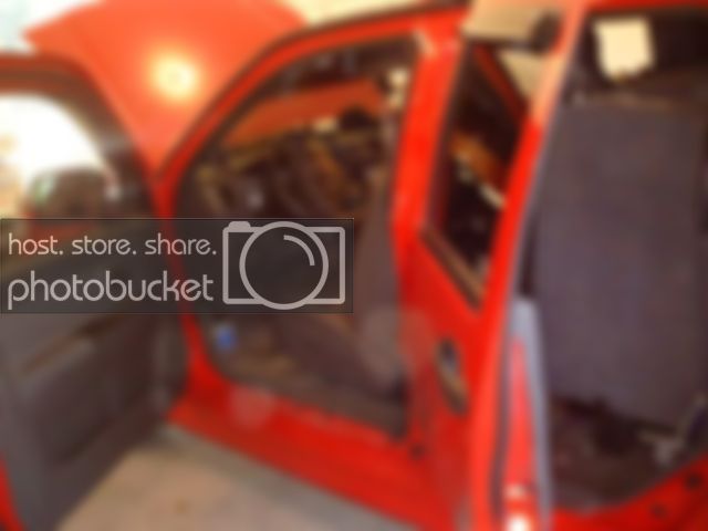

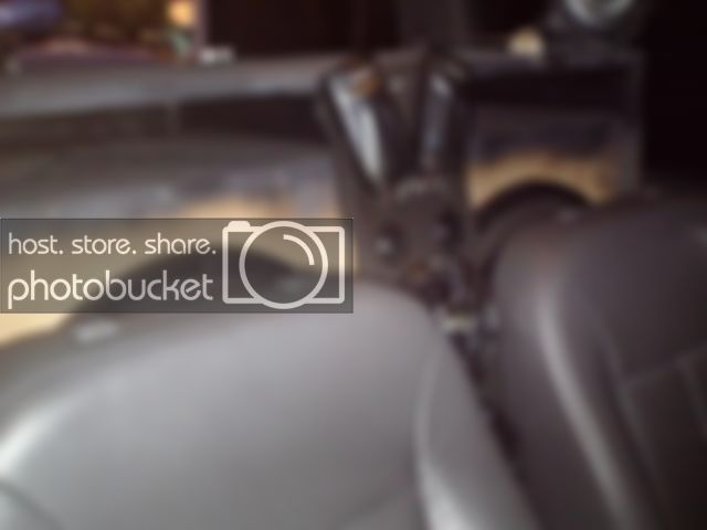

Anyway im 19 and have a colorado crew cab with 2 18" BL's..(not walled)
couple pix to show ya guys
Anyway, its not the prettiest thing by all means, but im a broke college student.

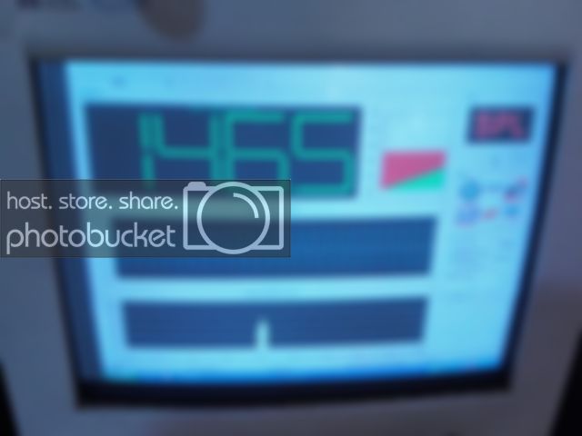

Anyway my question... My voltage has not been raising back up to its normal 14.4... or 14.5 it used to... instead its not at 13.8. However during music notes i will dip into 11.3's @ times and when i hit mute, stay at 13.2 for a long while*5 min or so* slowly creeping up. Do you think my alt diodes are crapping out on me? i just threw in a new deka up front to replace my yellow top, which seemed to do nothing beneficial. I do have the big 3 in 1/0, im just kinda lost. I really want to do a wall with 2 more 18's and a t40001 in the future, but i can barely keep my voltage up now.
