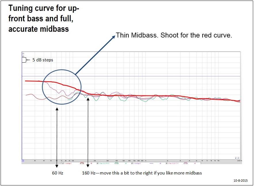

I realize now you aren't trying to do a typical SQ system, and that's great. I want to quickly go over a problem I've needed to solve and tried to prevent in the sound systems I've designed and installed.
The graph pictured below shows the range of 20 Hz - 20 kHz as measured in my car a couple of years ago. The squiggly purple line is a single subwoofer, a 6.5" mid-woofer(possibly even CDT HD-6) and a 1" tweeter.
The circled area shows an audible problem, a big problem. The midbass ******. This can be addressed in several ways, but tuning cannot fix this if your subwoofer can't play high enough to meet with the bottom end of the mids.
You can cut and cut some more with your EQ and amplifier gain adjustments to try to smooth out the transition, but it probably will totally remove the balls of the system. Nobody wants that.
