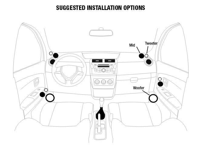

the manual has recommendations for placement
if you go with the doors, you just need to cut holes and use the mounting kits that come with the mid and tweeter. this will look the best but your soundstage may be too low. so it depends on what you're willing to sacrifice.
