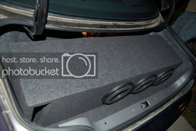

So Im going to need a new box. Heres the old box design.
Heres a crappy drawing of my trunk specs (yes, its tiny)
scaled.php
And heres that box in my trunk as of right now. Only difference is right now the box is flipped the opposite way (subs and port facing drivers seat) at the very very back of my trunk (towards bumper)

Heres what I want to do and what I need help with as well as opinions, since this is what I want to do and what may not be best.. I want to build another box, almost to the same dimensions as the one I have now. I cant go bigger.. it will not fit in my trunk. I want to use external aero ports. I think 2 4" aeroports will work good. Cant do bigger because port will be too long.. I want to stay around the 30-33hz tuning. Im at 33hz now and its fantastic but I could stand to have a bit more lows, but only if its doable.. I may not be able to make the ports long enough for lower tuning to happen. Ill do some measuring and find out tomorrow.
Heres the kinda tricky part and Im not even sure if its doable or how it would sound, but I know it would look cool if I can pull it off and still look clean. I know if I were moving more air from trunk --> car I would be getting less rattles from my rear deck (maybe staying clipped in?) and it should be a bit louder. I cant seal off my trunk because of its odd shapes and trunk hinges as well as trunk springs. I CANT do any sort of blowthrough my seats because all they do is fold down is a unit. Driving around with them folded down is stupid.
However.. has anyone ever seen someone cut a hole in their rear seat (I'll buy another rear seat for this, Im not modifying mine) and put aeroports flush with the cover which runs back to the box in the trunk? Im not even sure how it would sound, but it *should* be the same as doing a blowthrough with aero ports, just look cleaner.
Thats my idea. I want the box at the very rear of the trunk like it is now, all 4 subs facing drivers seat, and them seperated in the middle by the aeroport. I dont know if its OK for an aero and the subs to be on the same face of the box, nor do I know what size/how long of an aero to use, or tuning.. which is why Im asking here. I do know that the port will probably be around 20-26" long max. I'll measure tomorrow and see how long I can get it AND if this is even possible! My trunk opening is FRIGGIN tiny and Im not sure if theres even enough space for 2 4" aeros! Im praying there is.. could someone measure the OD of a flared 4" aeroport for me? Is it something like 5"? I may have to put them next to each other, and even then.. not sure if its possible. I'll do some measuring tomorrow.
Heres a crappy photoshop picture for what I want to do
But I may have to do it like this.
Will this sound good? Loud? Bad? Terrible idea? Just trying to figure out how to fit these 4 8s in my trunk, without building a bigger box, or building a box in my trunk, AND at the same time getting more bass from trunk --> cabin. Opinions? Thoughts? Thanks all, hopefully you read this far. lol
If anyone thinks theres a better way to achieve what I want, speak up! I really need to stick with 8s so I dont lose a ton of cash. I want louder in the car and less bass stuck inside my trunk!

I thought about the side port. It would still have to be an external aeroport, I cant fit any bigger of a box in my trunk. Not an inch an any dimension.
Also in that video if you watched it, my rear speakers are out. So even with the 2 6.5" holes in my rear deck, and my rear seat down, Im getting more boom in my trunk than in the car. Im getting so many rattles its ridiculous. My rear deck is deadened with AT 60mil, and I have some foam on it. My whole trunk is deadened as well.
Porting through my rear deck with PVC would work, sure.. but my rear deck would flop around like a dead fish even more. Thats why I thought of going through the seat.
As for the tackiness.. I would paint the aeroports grey probably. Or have someone cover them in grey sub box carpet or something so they didnt stick out.

Even if you put the areo ports in the seat, that would not benefit too much, port have to be tunned too. might drasticaly change the tunning.
What I saw from watching the video, is that I think your box is too wide. and the car has that cabin trunk half wall, That might also be interferring with the ait transfer. and I also see you have amps in the way too. What I would do is either shrink the box or re design, relocate the amps and battery to the rear part of the trunk. Maybe try a forward fire position. youd be surprised, using less subs might get louder in a smaller box too.

Today for giggles I may try to put the box inside the car in my rear seat to see how it sounds. Ill post back
Put it in my rear seat facing me.
Heres what I noticed. Rear deck doesnt rattle obviously like this... only thing rattling are my doors on certain freqs. The SQ is amazing. My subs are NOT blown if anyone saw my other thread, they are fine! They sound awesome.
But... it doesnt seem as loud? Someone explain this to me.

I did some more driving around, and I was wrong.. its way louder in my rear seat. It sounds amazing. No rattles except for my door panels and its loud as crap...
Now if theres just a way to put it back in my trunk and it still sound good, AND add a 4th SA 8. I cant leave it in my back seat.....

Not sure I understand, but this will give you an understanding of how tiny that opening is.
I can almost gurantee all 4 8s wont fit across there. That would be at least 34" or so, and that opening is probably 28". There would be no room for a port either.. the 3 I have MIGHT fit, but there still wouldnt be enough room left for a port. Pretty sure, but Ill check anyway. The left side is taller than the right if anyone noticed.. by a few inches. Its not an illusion. Thats the access for the fuel pump in the gas tank.. actually went in there not too long ago to fix my fuel gauge. Drifted around a corner and got stuck on empty. lol
