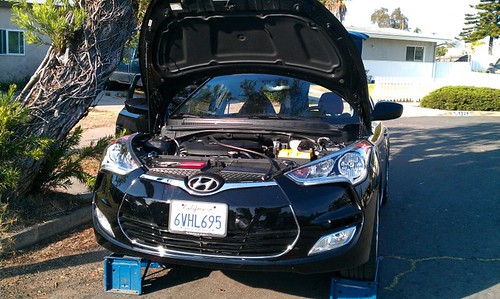

Ok, finally got an update. I found a couple of local guys to install my equipment for much cheaper than the shop I was originally going to. The shop was a little shady and it scares me when I talk about active processing etc. and they just have a blank stare on their face. Anyways, these guys (Ryan and Chris) do really good work, so for anyone in San Diego that wants good quality work done for a good price, don't hesitate with these guys. They don't try to rush and half *** and they take care of it as if it's their own vehicle.
So on to the car. I only gave them a day and a half with my car and they had a set back when Ryan had to go to the hospital for stitches....whoops.

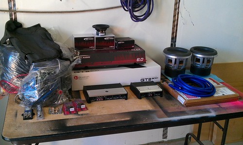

I decided to go with the JBL MS-8 and hopefully I get better results this time around considering I'll be using all stock locations and will be running a center channel this time. Here's some of the gear that's going in:

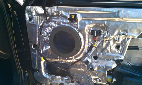

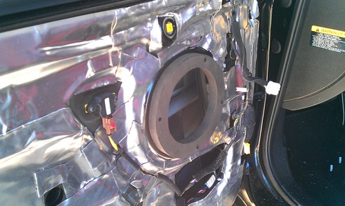

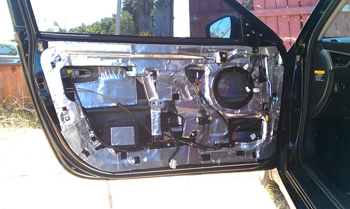

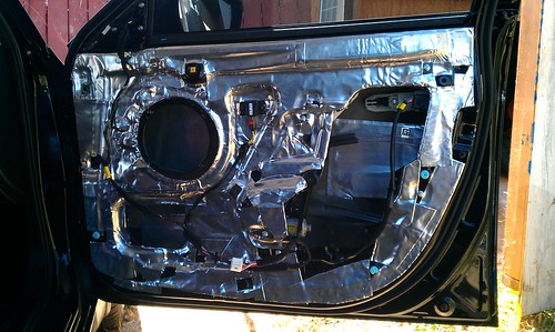

Doors panels deadened. The bigger holes will be covered with mdf as well once they get the car back and run all the wiring.

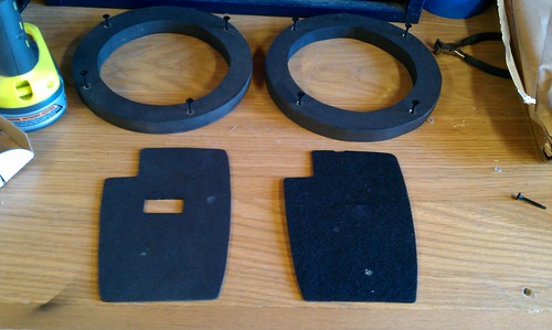

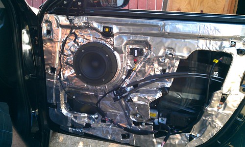

Mids going in. Apparently it was a PITA to get them to fit, they had to add to the original mdf rings and the drivers side has a little less depth than the passenger side.

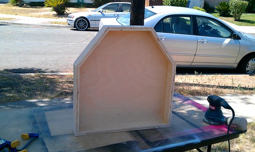

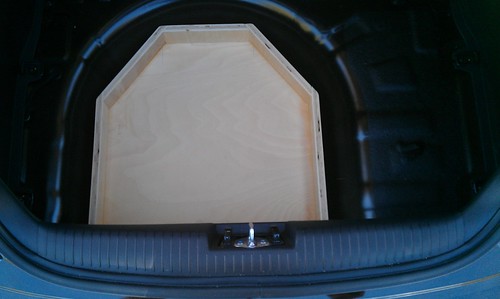

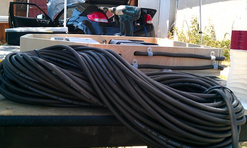

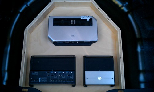

Amp rack for the spare tire area.

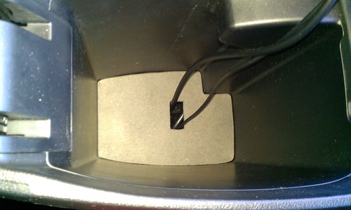

I had them route the ipod cable which will also play video through the center console so I don't have cables in the way.

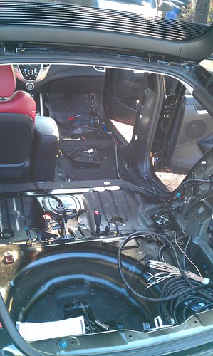

Got the car back on Tuesday, been putting up a fight still. I am beginning to believe this car was not meant to have any upgrades done to it, Seeing how the speakers are riveted in, the accordions in the door jam have zero space to run wire, and all the trim panels have no room behind them, but we are getting it done!
In order...

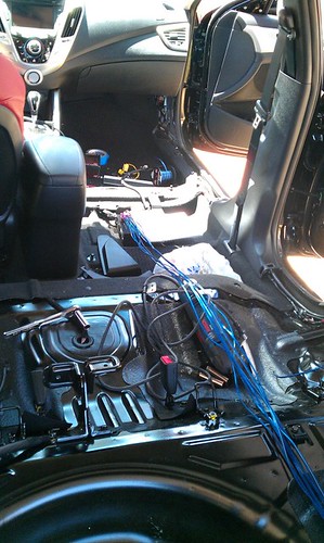

Gutted the car...
IMAG1256 by Beerdrnkr, on Flickr
IMAG1255 by Beerdrnkr, on Flickr
IMAG1260 by Beerdrnkr, on Flickr
IMAG1262 by Beerdrnkr, on Flickr
IMAG1259 by Beerdrnkr, on Flickr

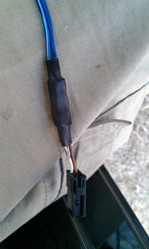

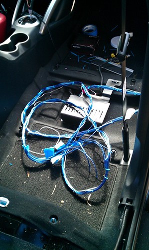

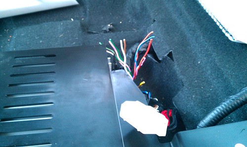

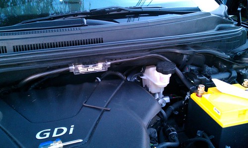

We then began to extend the wire harness from the stock amp to the MS-8, unfortunately i made the ******* mistake of hacking the stock plug off, now instead of getting the signal from the amp, the MS-8 is wire directly to the speakers, now i gotta go get a new plug and fix that.... This was a reminder of why we work slower to make sure we don't make dumb mistakes like this... Fortunately this isnt a costly mistake, nor is it gonna put us back more than 20 or 30 mins, just gotta hope hyundai has them in stock, as soon as i finish my coffee im heading out to get one.

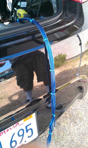

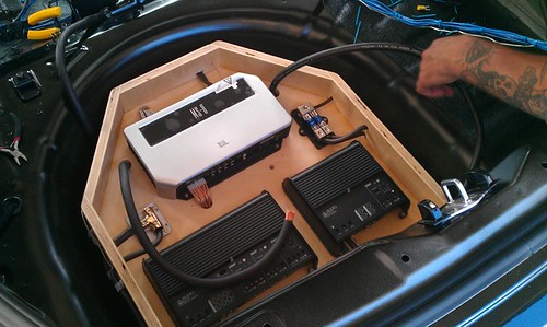

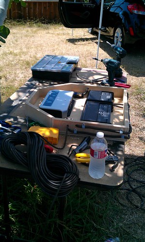

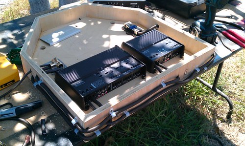

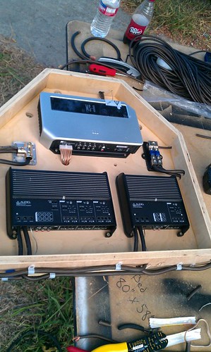

Started wiring the amp rack, this is just a "mock up" we are waiting on the actual distro's that will be getting used, had to make due with what we had to make sure everything would power up. The amp rack also needs to be carpeted and have the trim finished on it, you will see when its finished.

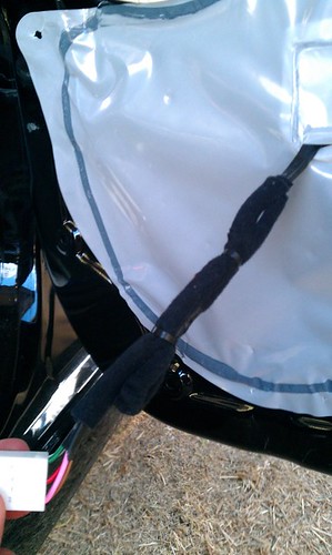

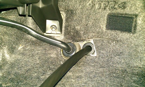

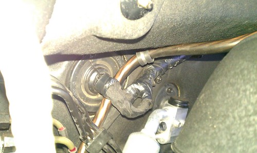

The two rear speakers will be running off of the logic7 in the MS-8, (input 6 & 7) i didnt have too much trouble getting through the accordion on the back 3rd door.

We will also be adding fans to the amp rack because the JLs and MS-8 are running pretty hot.
