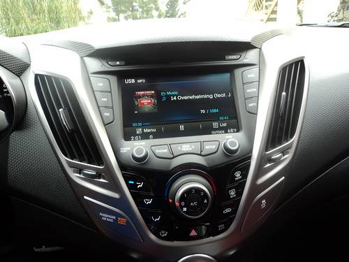

Well I just picked a new car about 2 months ago (2012 Hyundai Veloster) and of course instantly started seeing what I could with it audio wise. Unfortunately, I traded in my last car and had to leave my Skar 15's, 4 Massive Audio amps, Scanspeak Speakers, and my beloved Pioneer P99RS in it //content.invisioncic.com/y282845/emoticons/frown.gif.a3531fa0534503350665a1e957861287.gif So now I gotta start from scratch.
I want to try and keep as much space as possible available and want to keep it stock looking.

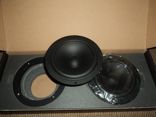

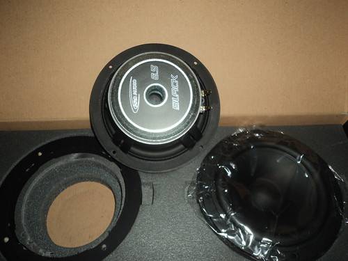

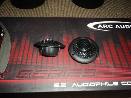

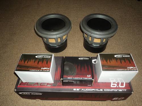

Speakers: Arc Audio Black Series 6.0 (6.5" doors), 4.0 (single 4" for center ch.), and 1.0 (Tweeters) all ran active. Stock rears will be used with option to fade them off.

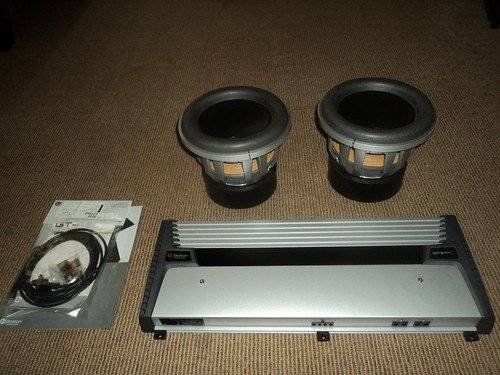

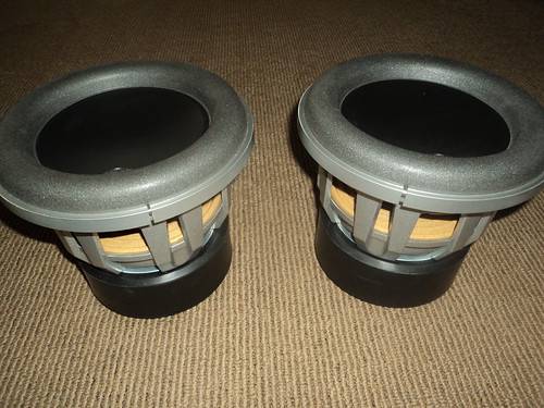

Subwoofers: 2 JL Audio 8w7's in JL spec'd ported box (2c/ft tuned to 34hz)
Amplifiers: Boston Acoustics GT-2300 sub amp. 1400wrms at 2ohm.

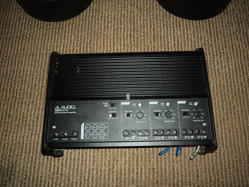

JL Audio XD600/6 ran in 3ch. mode (200w x 3) 6.5's and single 4" center ch.

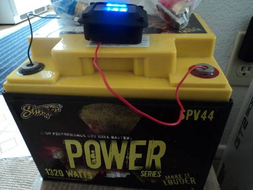

Electrical: Stinger SPV44 under the hood, 0g wiring, big 3 upgrade.

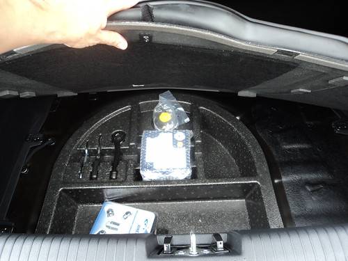

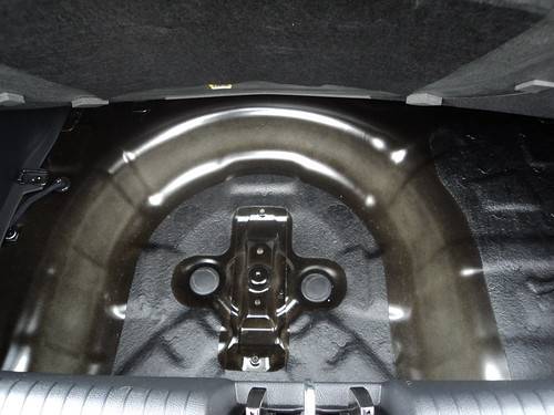

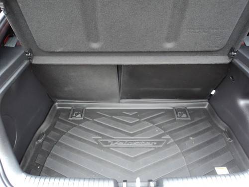

So that's the list of current and future mods for this car, it's not fast at all and it's pretty much an economy car so I want to keep it nice and light. I'll be using birch for the box and amp rack. The amp rack will be installed in the spare tire area where there's a fix-a-flat pump put instead? lol. Should be plenty of room for the amps and will be well hidden.

The new tw5v2 would be somthing to look into if your looking to save space and are looking specifically jl
he already has the subs and the w5 takes up about as much room a the 8w7 if you consider the actual recommended sealed box size.
2 8w7 1cube
1 13w5 .9cubes
and the 8s would dig deeper but that doesnt matter since he is porting the box for more output.
sorry to thread jack the equipment looks awesome though and i cant wait to see this coming along
he already has the subs and the w5 takes up about as much room a the 8w7 if you consider the actual recommended sealed box size.2 8w7 1cube
1 13w5 .9cubes
