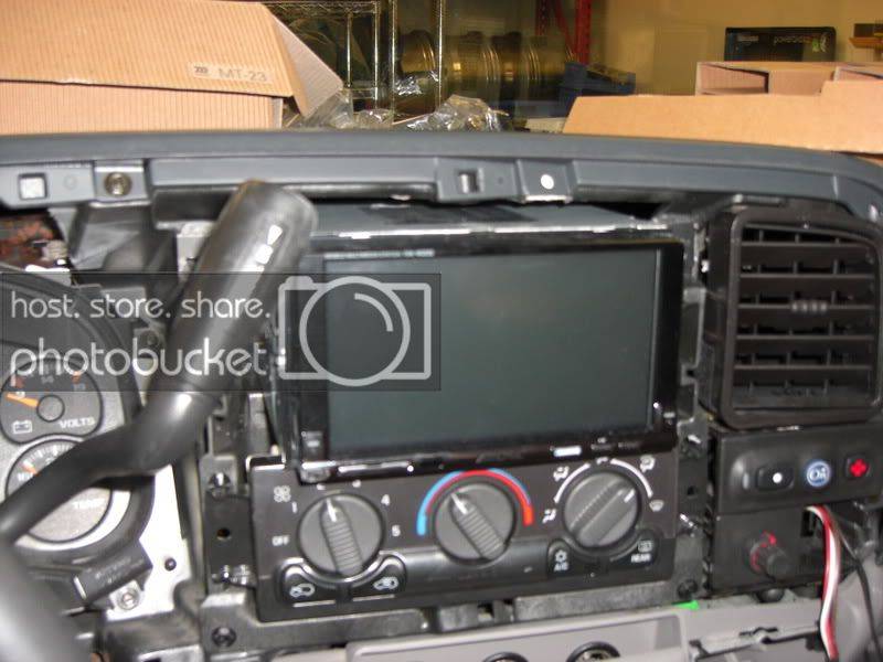

Sub/amps must be hidden. Dash required modification for double DIN opening

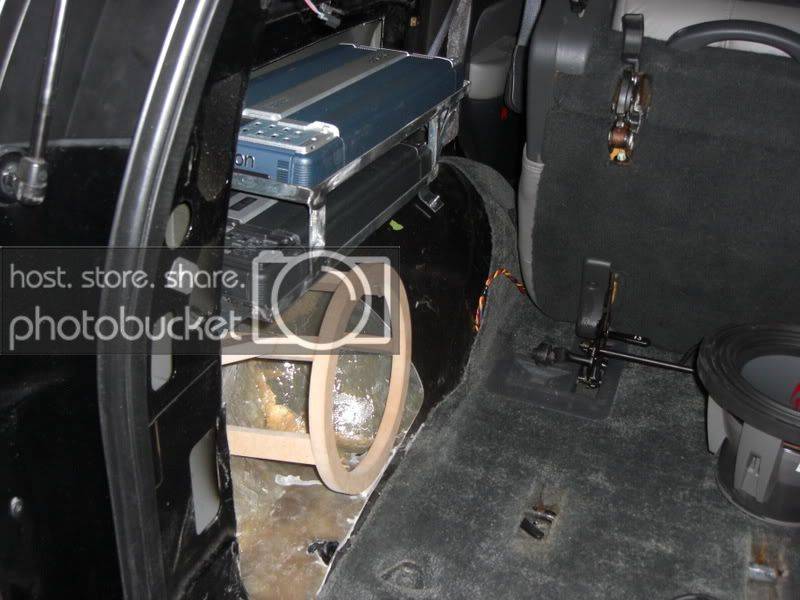

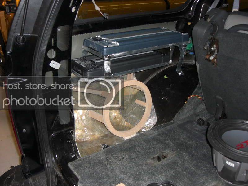

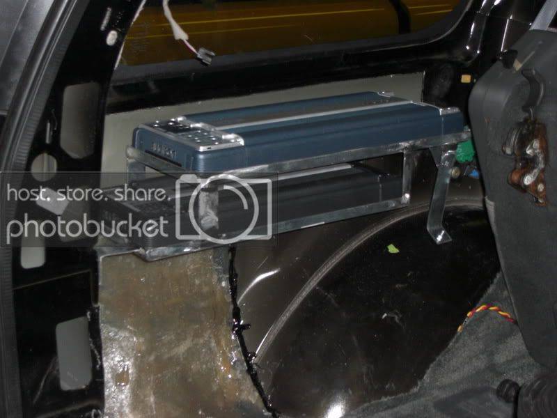

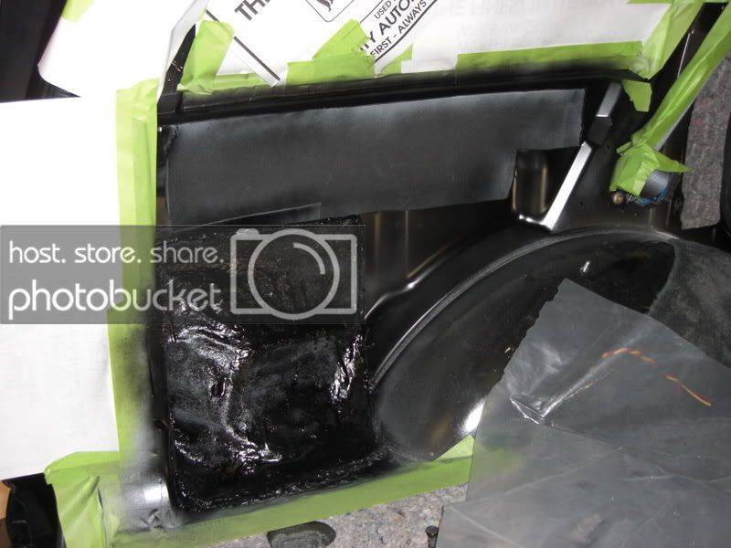

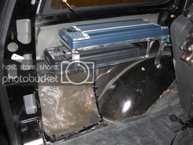

Gained a ton more space by cutting it out.
nice rack
Had the mechanic weld it up for me since I don't know how to weld.
how did you go about getting the double DIN in there? I've been wanting to do this to my avy.
Requires cutting the top of the inner dash and the dash brace. I took an air saw to it. Bend radio straps to the factory mounting points for the gauges and air vent. Also have to trim the dash bezel.

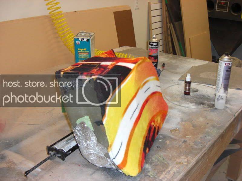

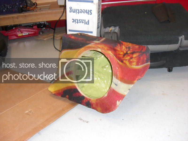

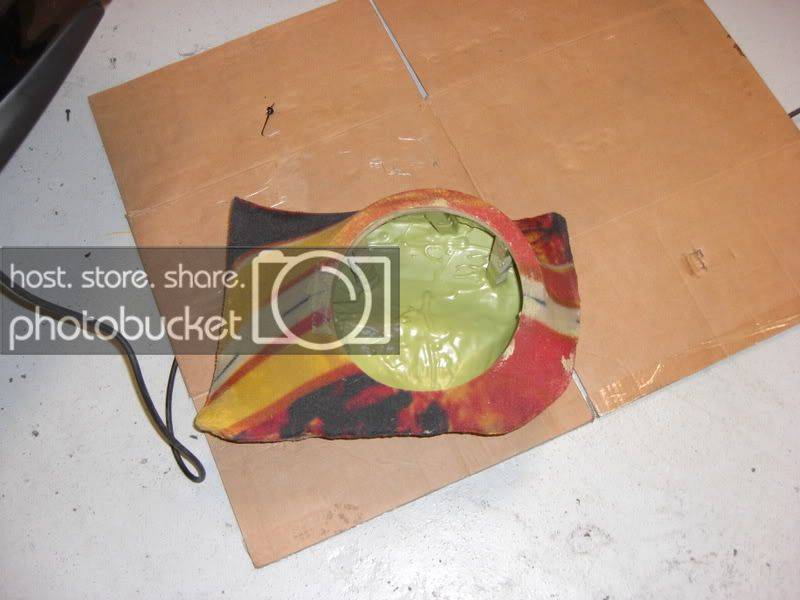

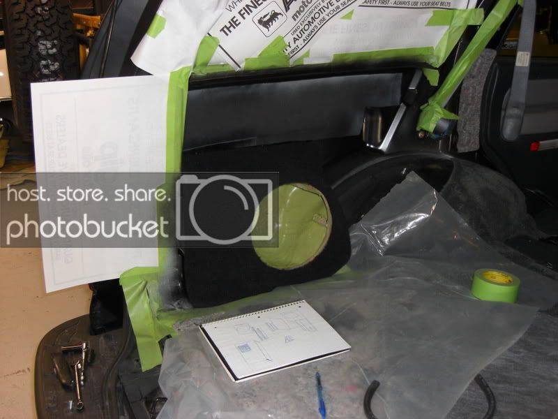

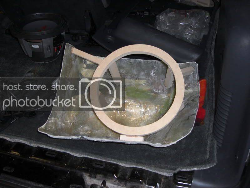

looks sweet, but where is the glass on the front of the box or did you skip that picture?
If its the pic with the 2 amps in place that you are talking about, I cut out the area around the gas filler neck and made a fiberglass mold of the neck then Duramix 40/40'd that to the body of the car. Had to find some airspace
