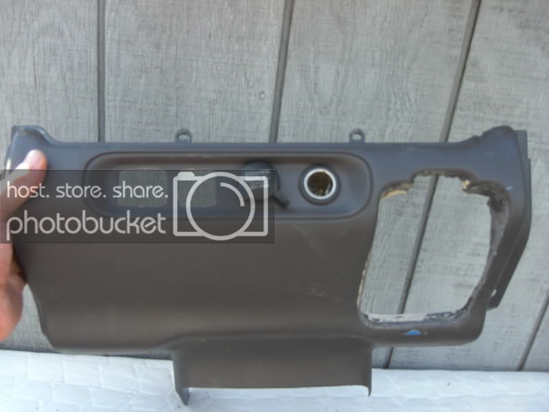

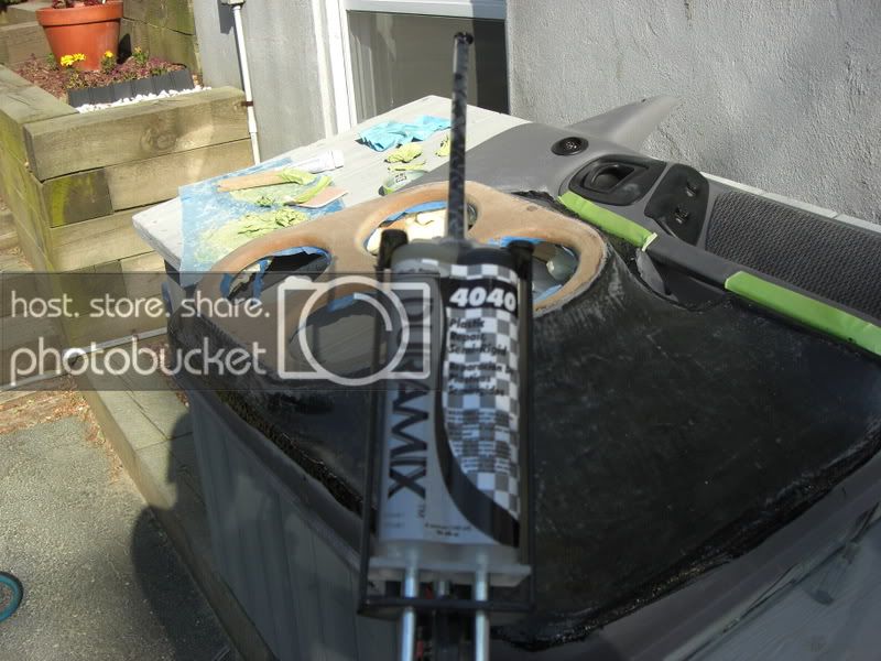

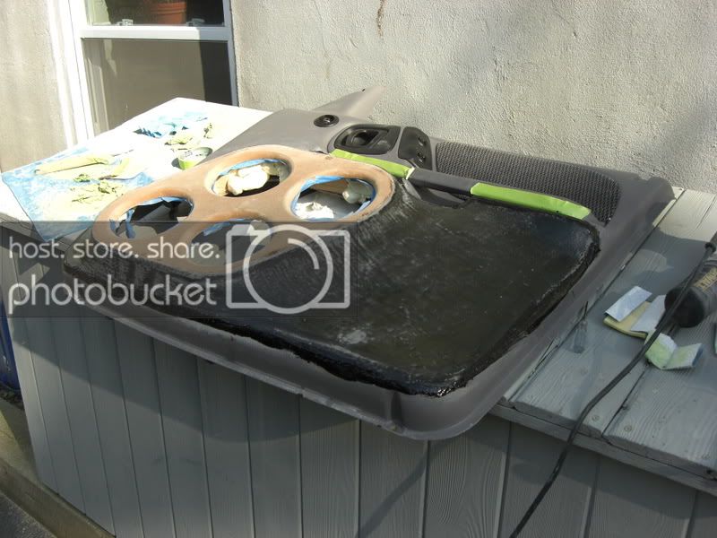

Well I planned on having these ready for paint by today... I was gonna spend all weekend on them but spent most of time getting drunk and going to bbq's instead. One needs a little more filling and the other one needs to be filled completely. I used duramix 40/40 to blend the edges together as body filler would not hold to the panel well. I then also used the 40/40 to shave my ashtray and 2 switches.
40/40 on the edges

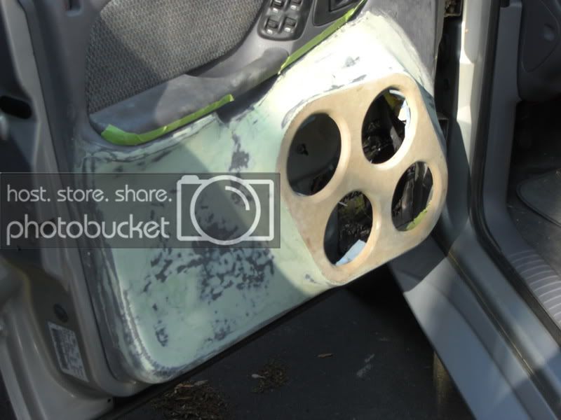

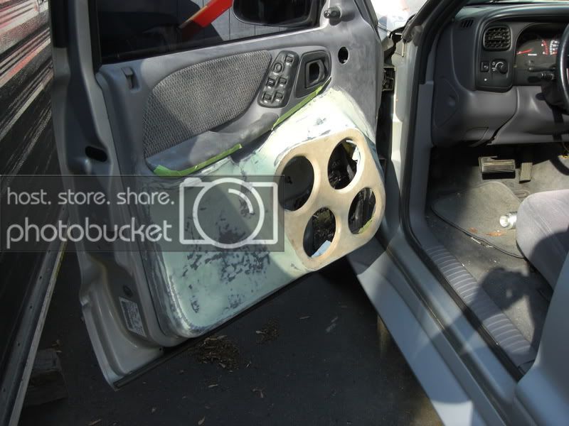

Little more mud and sanding and we can go to paint.
Ah the 40/40
Panel that I shaved the ashtray and 2 switches on. Forgot to grab a pic of it filled but basically just 40/40'd the holes after I taped up the front of them

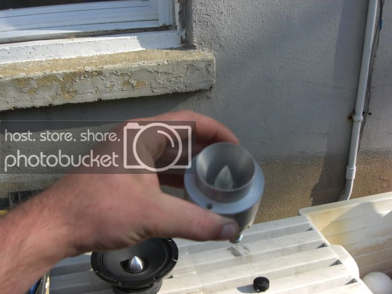

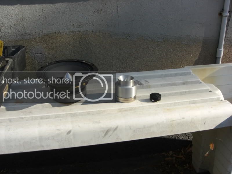

Mid and Beyma tweet sitting next to my old Memphis tweet
Ginormous tweet

So is that 4040 stuff just something that comes out of the tube, you smooth it, it hardens (how tough is it?) and you sand it the shape u want?
looks pretty cool
40/40 is a 2 part epoxy that is made for repairing abs plastic and such. Once it hardens its just like plastic.
