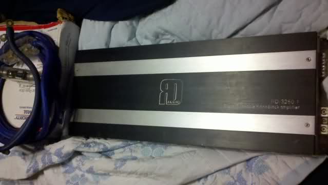

rd3250.1V1

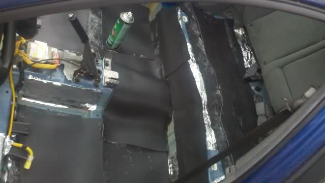

Today i installed 80 mil deadner from AUdio technix. Let me tell you UPS FU*ked up my package of 25sqft and cthedinger is willing to reship me a whole roll to make up for this. he gets a A+ in my book //content.invisioncic.com/y282845/emoticons/smile.gif.1ebc41e1811405b213edfc4622c41e27.gif

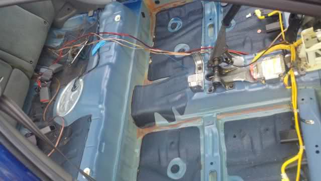

FIRST OMG let me tell you, under the carpet was foam liner that spanned the WHOLE FLOOR tons of factory deading also. im so impressed. in all my years of watching car builds ive never seen anything as much as my car has. Dark blue on the floor in the pics is factory deadner, a foam material. ill get pics of the foam liner that went on top of that deadner
got most of the floor done and the front doors with 90m spray. Layed most of the floor with CCF from Raamaudio and the SS LL on top of it. let me tell you luxury liner does not adhear well... to anything lol, deadner, sheet metal, ccf nothing sticks lol hopefully the carpet going back on top helps keep it place. tomm will be laying wires and routing door speaker wires if things go well. be about another week till i get my alternator and 3400.

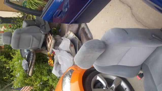

All the seats and such out next to my 350Z

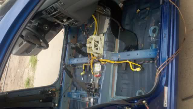

front seats gutted and center consoul gone
