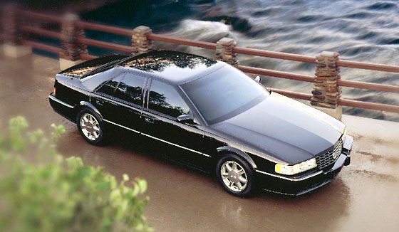

Sup everybody, looking forward to building my first system but I need some suggestions on what parts to buy.
The car is a 1997 Cadillac STS Seville, and its got some BOSE crap installed in it right now. So I'm looking forward to an upgrade.
