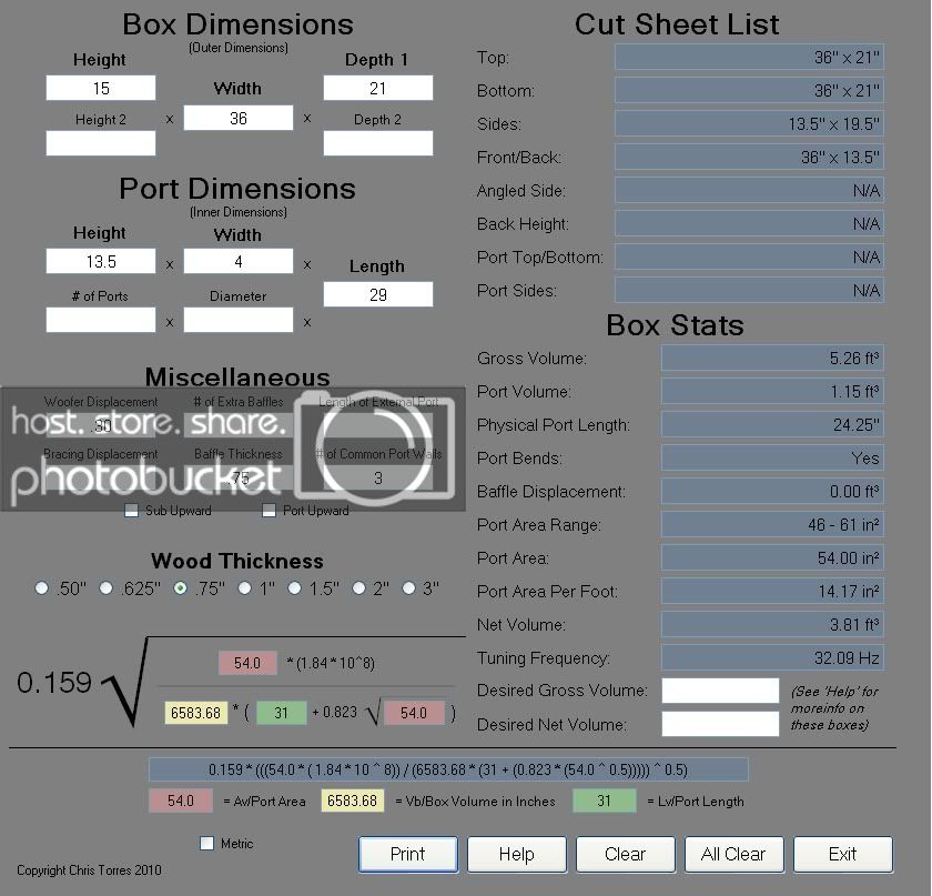

should this work? gonna do subs up port back.

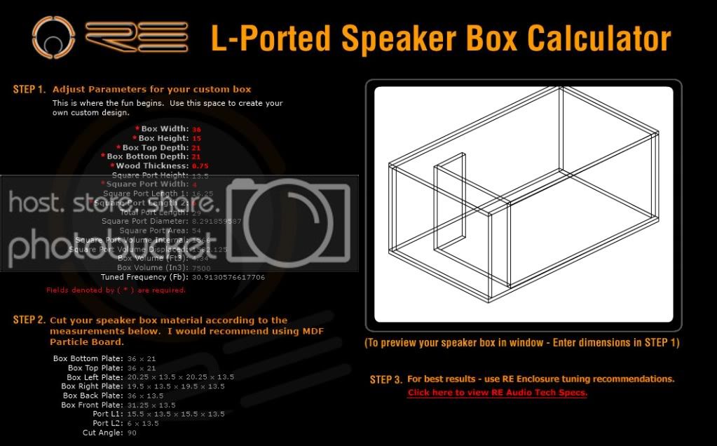

ok this might be my final design. I used re calc to get the port length and used the other calc to give me my final specs including displacement.
Does that box I designed need to have bracing or is it good enough how it is?
Going to be running 4-4600watts rms on the two 12's.
And is the tuning alright at 32hz? I want it to be a loud ground pounder.
