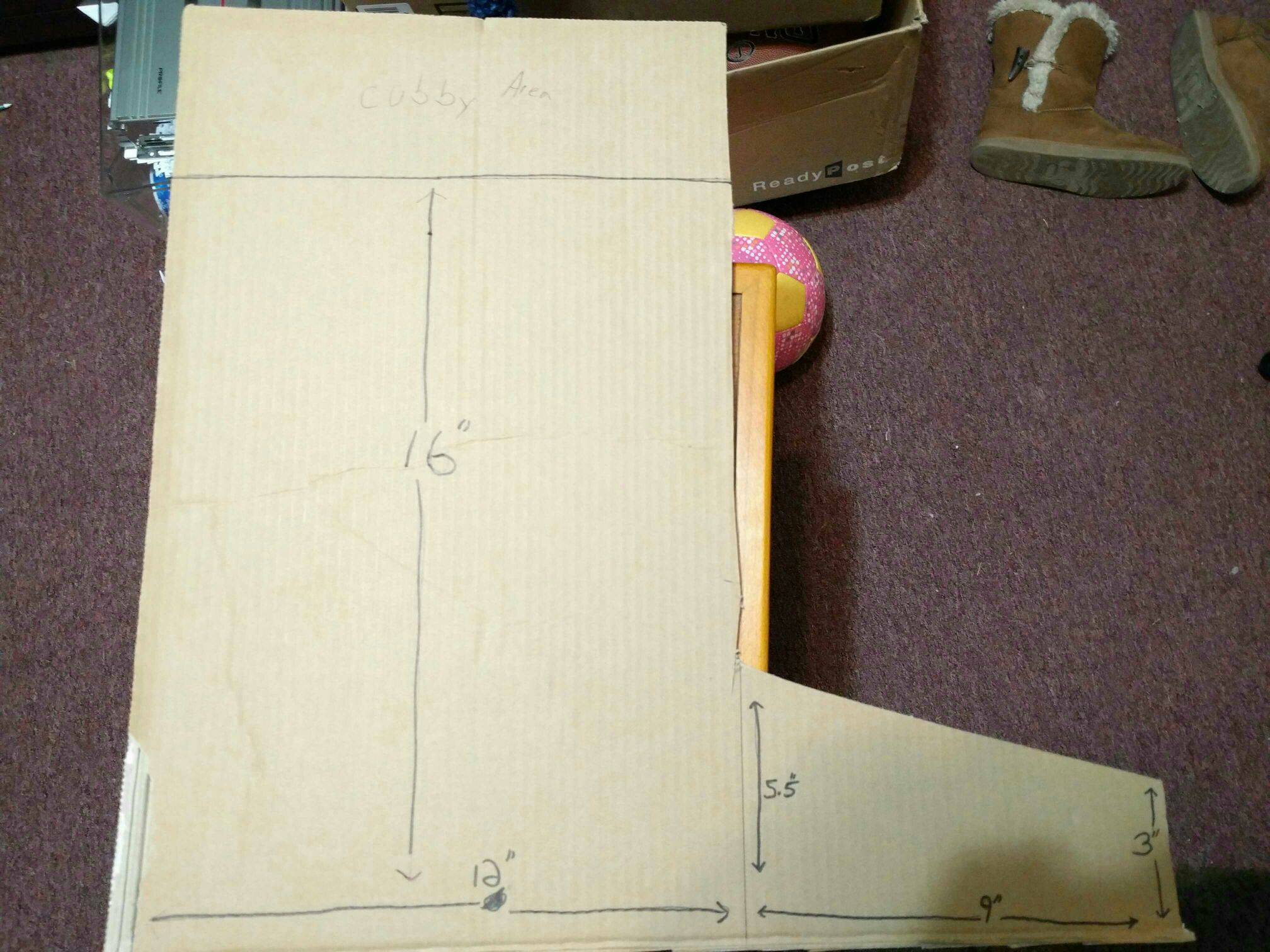

I'm gonna use just 1 sub. Silverado space is very limited. This is the preliminary look. I cut out on card board first to get an idea on what I can do. So far I'm looking at 16 tall x 16 wide x12.5 deep for the rectangle. The triangle part will be depth 1= 3", depth 2= 5.5 , height =9
All total thus will be about 16 inches wide. From my calcs I've come to the rectangle part is 1.338 cu.ft . the triangle area is .173 cu.ft. comes to 1.511 then minus the sub's displacement of .052 a final number of 1.459 cu.ft. this is a rough estimate before I cut but I have no clue as to figure out the port build due to the weirdness of the shape.
