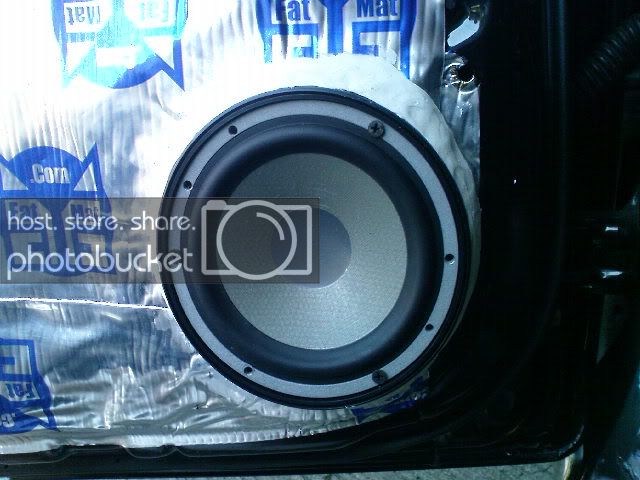

here are a few pics of what i have done to my car. it is a pure SQ car.

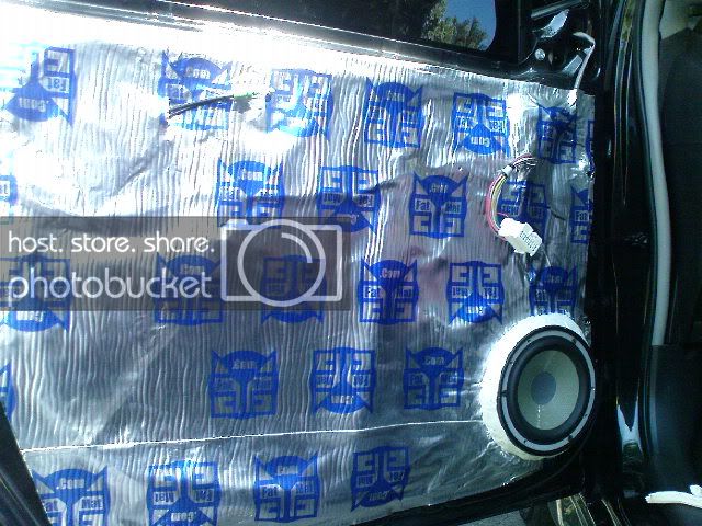

first of here is what i did to my doors....
i totaly seald all the holes i could then placed clay on the speaker monts to seal it as much as possible.
do you guys think i should put a hole for some breathing space for the speaker or is that the best way to do it.

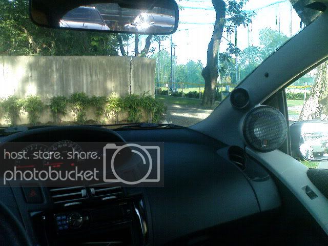

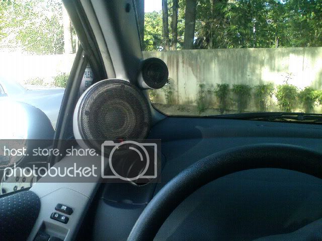

then here are my speaker placements. i run a 3 way config. my mid bass are on the door and the res are on top of the dash. i run a 175w x 2 amp for my mid bass and 80w x 2 for my mids and tweets. my mid bass is run full active.

im a noob but, im pretty sure you need way more air for those mids on the pillar ...
door looks good tho
but ideally you want all your speaker in the same area of the door...
