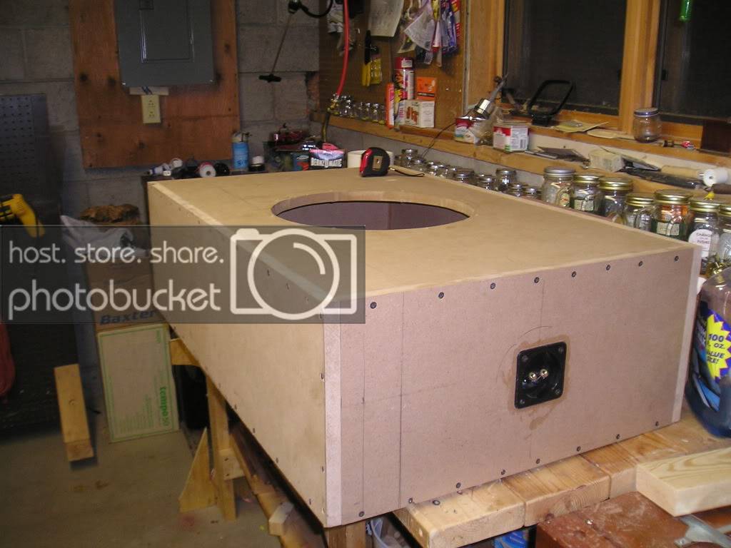

At first I though PVC, but I figured there might be port noise because of the non flared ends. This is what I have right now (x2)
TWO 3 INCH SUBWOOFER SPEAKER BOX AIR PORT TUBES 3 INCH - eBay (item 120547301701 end time Aug-19-10 18:50:48 PDT)

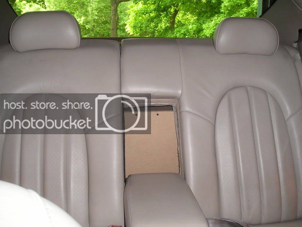

The problem is that hole in the armrest is only 8" x 9" so I can't really do a huge port (2 6"s).
You could use a single 6" aeroport from partsexpress.com, but then you'll end up with the port being in the way of the sub since you have the sub in the middle as well. Those little 2.75" ports just aren't going to cut it. Not to mention if you use both you don't have enough length to tune as low as you want, and if you do one it'll be port noise to high heaven.

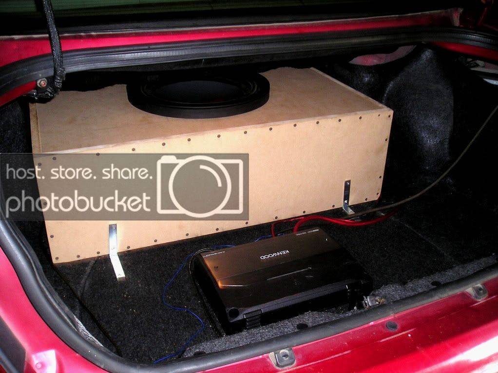

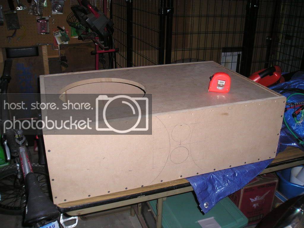

Oops, box design has changed a bit. I accidentally uploaded an older picture. Here's the current build. As you can see I moved the woofer over and have enough room to throw an additional one in if need be.
What's the problem with having a smaller port like this? Do you guys think there would still be too much port noise?
I'd also like to keep the build simple as possible, so I don't really want to throw out a perfectly good box and start over with a slotted port.
