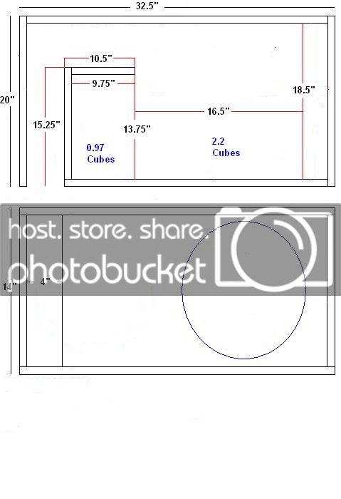

Need plans for 3cubes @ 35hz.....
I got plans at home. My box is exactly 3 cubes @ 35hz... got 52in^2 of port tho. Might be too big for ya. let me know...
[-edit-]
my box is 14.5" tall //content.invisioncic.com/y282845/emoticons/frown.gif.a3531fa0534503350665a1e957861287.gif
How much port area do you want?
How much is the driver displacement?
This one is 3.17 before driver displacement so if your driver displacement is 0.14 - 0.20 that will be fine.
It is tuned to 35hz
50 Square inches of port area
