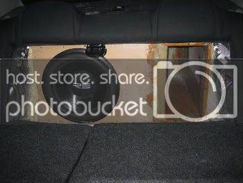

Here's how I did mine. Did a 149 @ 34Hz this year, so not bad for a daily driver...
I put 3/4" weatherstip tape along the front edges, so it seals against the 1/2" MDF grill. Rear seats still go up, so it can be stealth if needed.
